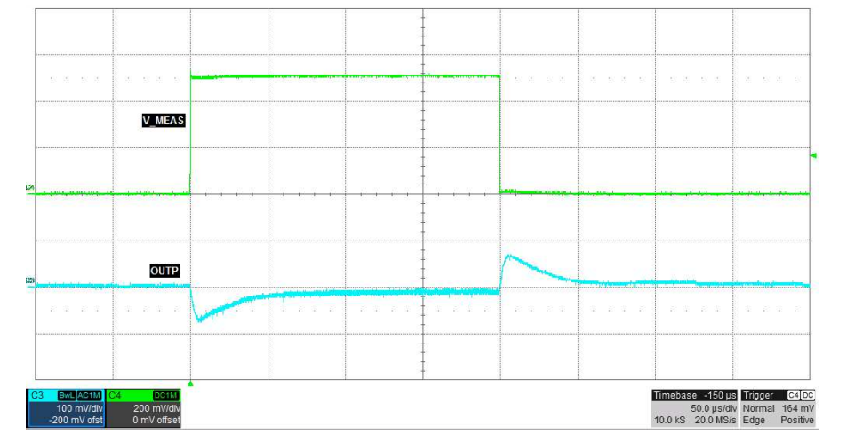

    3. For load transient test, if the output voltage waveform behaves like below picture. That means the phase margin should be big enough(>45).

    I believe my phase margin is ok as I see a similar result.  Corrected simulation is attached.  The step is applied at 2mS so you only have to run the TINA transient sim for 3mS.
