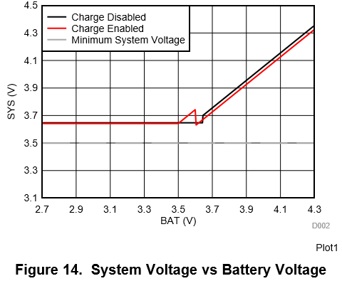

    The BQ25606 does have battery overvoltage protection and battery over-discharge protection, as described in Section 8.3.8.5 of the datasheet. However, please note that Vsys_min = 3.5 V, so VSYS will always be regulated above 3.5 V. Figure 14 below shows the relationship between VSYS and VBAT.
    Therefore, if VSYS must be regulated to 3.3 V, you may want to look into adding an LDO.

    No, VSYS will not be regulated at 4 V. Assuming your battery charge voltage is 4.2 V, then VSYS can range from about 3.68 V (Vsys_min + 180 mV) to 4.25 V (VBAT + 50 mV), as shown in Figure 14.
    How strict are the 3.3 V and 4 V requirements? Do they need to be tightly regulated, or is it okay to supply them with a slightly higher voltage?

    Unfortunately, this is not something that can be done with a battery charger IC alone. Regulating a 4 V output is especially problematic because this is right around the battery voltage as it is being charged, so VSYS (which ranges from about 3.68 V to 4.25 V) needs to be stepped up in some cases and stepped down in other cases.
    In order to implement the 3.3 V and 4 V rails, you will need to add more components to the output of the charger, such as a buck-boost converter or an LDO (to regulate 3.3 V) followed by a boost converter (to regulate 4 V).
