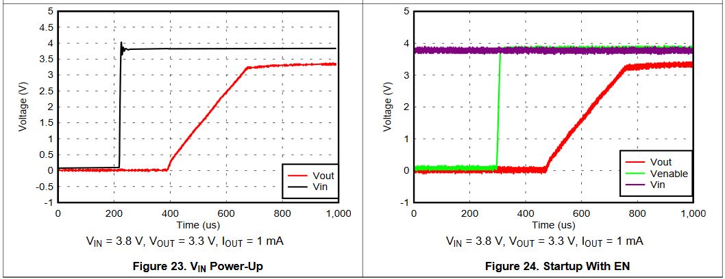

This device has internal soft-start. Is it “constant current operation” during startup with soft-start?
thanks and best regards, Katsu M
