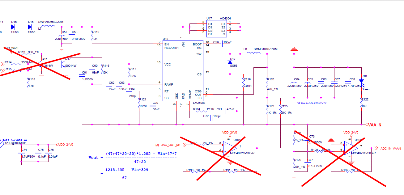

  We design a negative circuit using LM25088. The spec is Vin=24V, Vout= -10 to -18V @1.5A.
 When the output is below -11V(-11V, -12V, -15V, -18V)  with no load, the MOSFET AO4354 is very hot. the temperature is above 80℃. when it is on 1.5A load at with any VOUT, the temperature of  MOSFET rise up 110 ℃ quickly. We disable it.
Can you check the schematic to improve it ?
