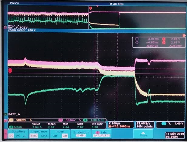

This issue will happen when the battery exist only without adapter
When the OUT pin have suddenly current transient from 1A to 3.5A ,Vout-Vbat will bigger than 250mV and the charger will turn-off the OUT
I saw the continue current support 5A on BQ24075T
May I know the current transient limitation of BQ24075T? or have any idea how to solve this issue ?
Below
Pink = VBAT
Yellow = OUT
Green = Battery output current
