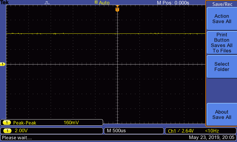

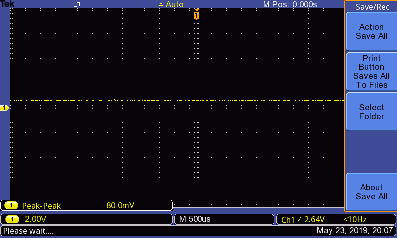

  • Hi Onyx,
    this is the scope shots you required:
    1. Vbat
    2. Pack p
    3. Chg and dsg
    Kindly regards,
    Wenlong

  • You were to measure chg to gnd and dsg to ground.
    Why is the gate signals pulsing? I believe you have a defective IC. Either you replace the IC or purchase a new EVM.
    thanks
    Onyx
