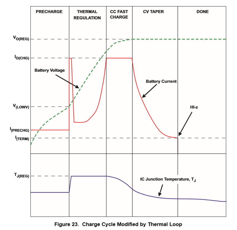

Dear Sir,
BQ24073 have charging suspend mode by thermal loop that BQ24073 reduce charging current when Charging suspended by thermal loop.
How many does it reduce charging current when Charging suspended by thermal loop?
can you let me know charging current in Thermal regulation?
  • Hello Dexter,
    The thermal regulation loop is an analog loop. This loop reduces the charge current until the junction temperature is at the thermal regulation temperature of the device. Since there are lots of different variables from device to device, it's hard to say the exact charge current the loop will reduce the charge current to.
