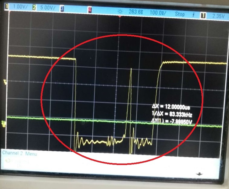

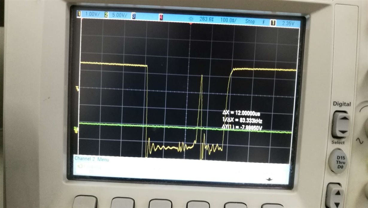

We designed a full-bridge converter using the UCD3138, similar to UCD3138HSFBEVM-029.but there is a problem with the secondary synchronous rectifier drive waveform during startup, one of the  synchronous rectifier drive waveform is as follows.It can be seen from the figure, there is one more pulse between the two synchronous rectifier drive waves. Can you  tell me what can cause this to happen? And how to eliminate this pulse ? Thank you.

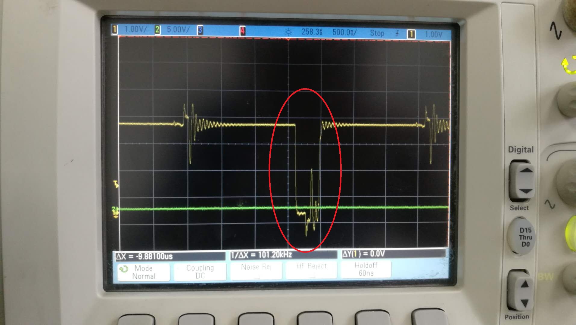

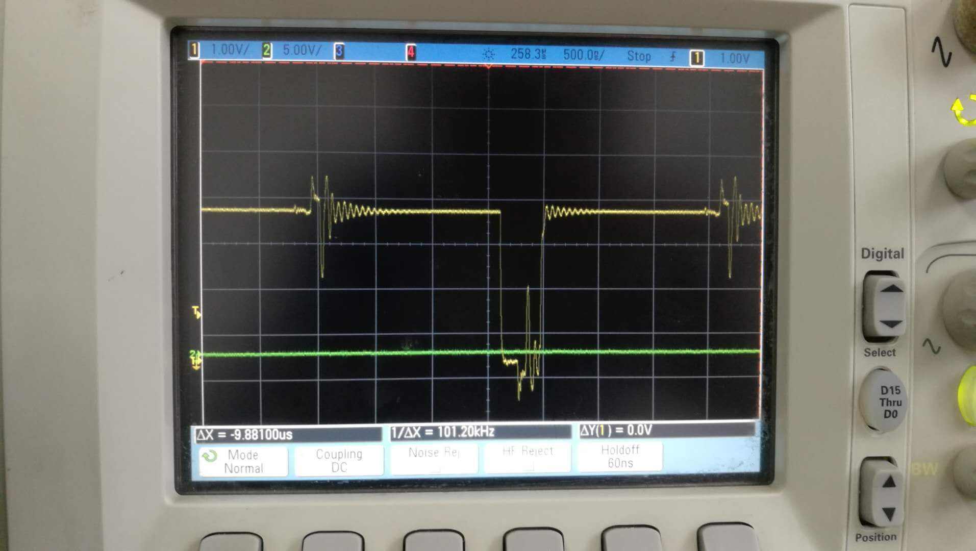

  • The waveform on the input to the gate driver  is as follows:
    Zoom in on the image as shown below:

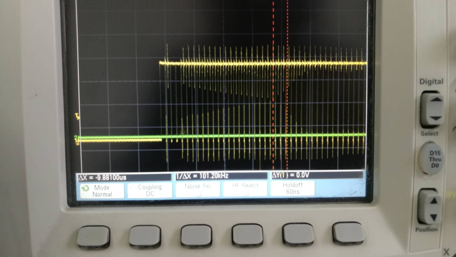

    The startup time is about 10ms. This pulse occurs in the first few hundred microseconds. Because the secondary uses synchronous rectification technology, the circuit should be in continuous mode.
  • It's not explicitly clear, but it looks to me like the circled section on the gate driver:
    matches the circled area on the UCD DPWM pin:
    If that is the case, I think it's a system noise issue, rather than a firmware or hardware logic issue.  We do have layout guidelines for the UCD itself that you need to follow carefully:
