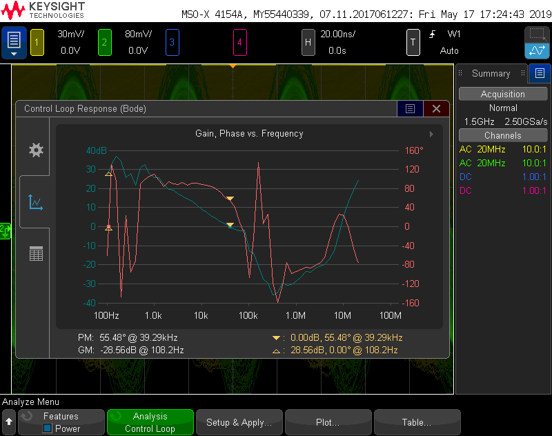

Ok Sean.
My requirement is 17V, 190mA. Vboost max is 22V (30% of 17V) Iset is 50mA each channel. I have used 2 channels for one LED string and 2 other channels for another LED string.
Fsw=2.2MHz
With CFB=7pF, T divider used R1=100K, R2 to gnd = 39K and R3=100K to FB pin of the LED driver.
Refer to the loop stability plot attached.
Phase and gain margins are not good.
Kindly guide me through this.
Vidhya

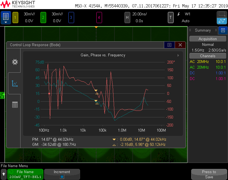

Sean,
There is flicker issue observed on board.
For a stable system, Gain margin should also be met.
Is it ok if only Phase margin is met?
Vidhya
