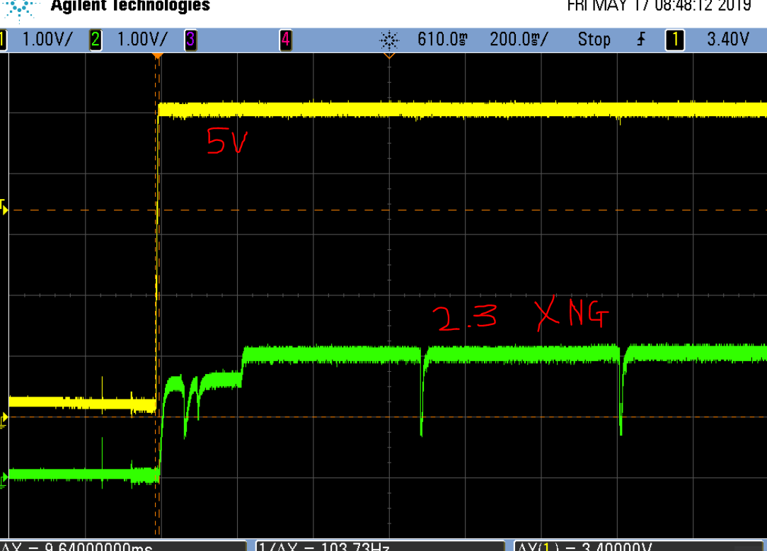

We have assembled around 400 units using TPS65218B1 series PMIC
almost 300+ boards work fine with no problem at all,
On all board, we have the same PMIC TPS65218B1 series
Few PMIC does not work as desired and we measured the temperature around PMIC is 20-25 deg.
Few PMIC board works fine even at 50- 65 Deg.
Now we would like to measure some checkpoints on PMIC, please suggest how to and what to check so that we can identify the bad/abnormal PMIC vs Good PMIC.
We have both PMIC boards (Good and BAD PMIC) but unable to find differences or unable to figure out bad points in bad PMIC,
Our end customer is asking to tell us waveform or impedance or other points in BAD PMIC which is different from Good PMIC.

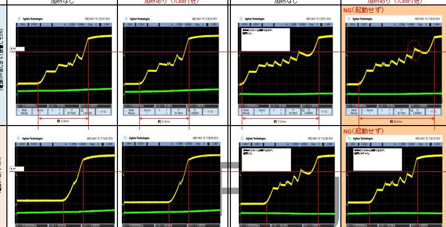

IN below image Yellow color is VIN_DCDC4 and Green color is output which is Zero
1,2,3 Column we are getting 3.3V output but the last column (4th)  is NG means failed, PMIC failed to output 3.3V
IN below
please suggest any clue or checkpoint by which we can figure out the differences
Please reply to my every point mentioned above
Thank you in advance

    I do not understand your explanation of the scope shots and cannot advise on them with more info.
    How is Yellow line VIN_DCDC4?
    What is the difference between top row and bottom row of images.
    It is not clear to me what I am looking at, so I cannot advise.
    When DCDC4 fails to startup, it will cause the entire system to reset. What other information is required?

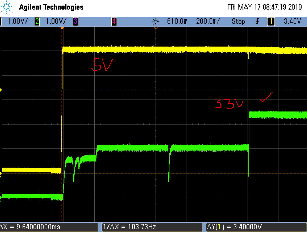

  • IN above image
    VIN DCDC 4 is 5V which is captured below
    pls. find updated waveform.
    1. image - waveform - 3.3 V Output failed to start
    2. image 3.3 V OK
    IN our testing we observed that same PMIC initially start properly but after 1-2 hours fails, NO 3.3V output.
    In another board PMIC after temp rise by 30 deg. then fails initially start and works

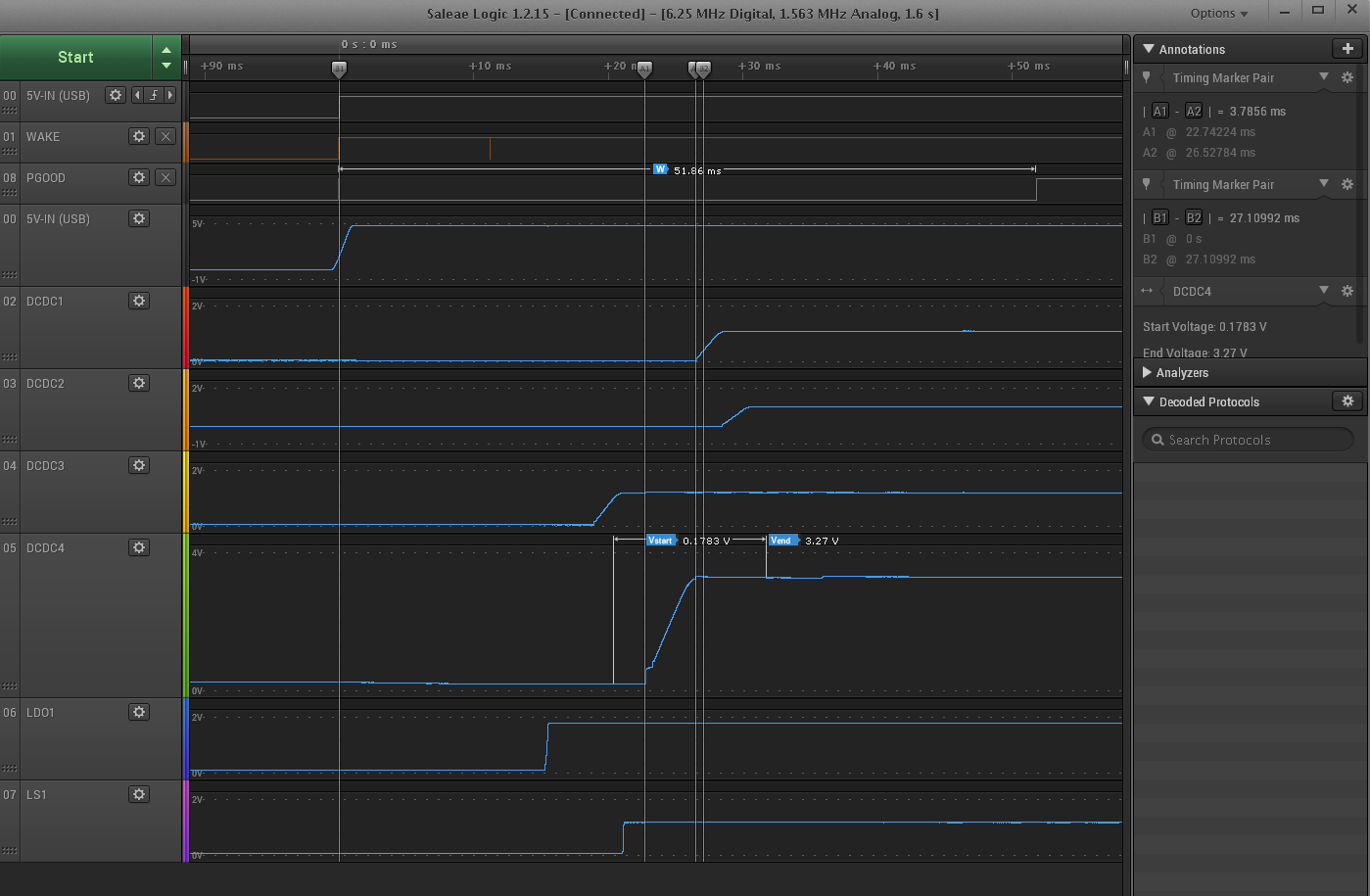

    I'm sorry, but if these measurements are accurate for the time it takes DCDC4 to turn on in the "Pass" case, then it my belief that neither of these scope shots show DCDC4 are working correctly.
    DCDC4 should approximate a monotonic increase from 0 to 3.3V, and it should only take a few ms for DCDC4 to reach the setpoint of 3.3V
    The entire power-up sequence should only take approximately 50ms, as shown in the scope capture below that I have just recorded in my lab.
  • To me, it does not make sense that DCDC4 can initially rise to ~1.6V, then rise to ~2.1V, then at a much later time finally rise to 3.3V and this is not causing any problems in the system.
    The VPG "time-out" specification is defined as "Occurs at enable of DCDC4 and after DCDC4 register write (register 0x19)" with a typical value of 5ms. If it takes longer than 5ms for DCDC4 to reach 3.3V, I would expect the system to power-down and try to re-start.
    In order to understand what is happening in your system, I would need more than just VIN (5V) and DCDC4 monitored on the scope. For example, when goes the PGOOD signal go high? When do DCDC1 and DCDC2 go high? All these timings are relative and dependent on the previous step in the power-up sequence.
