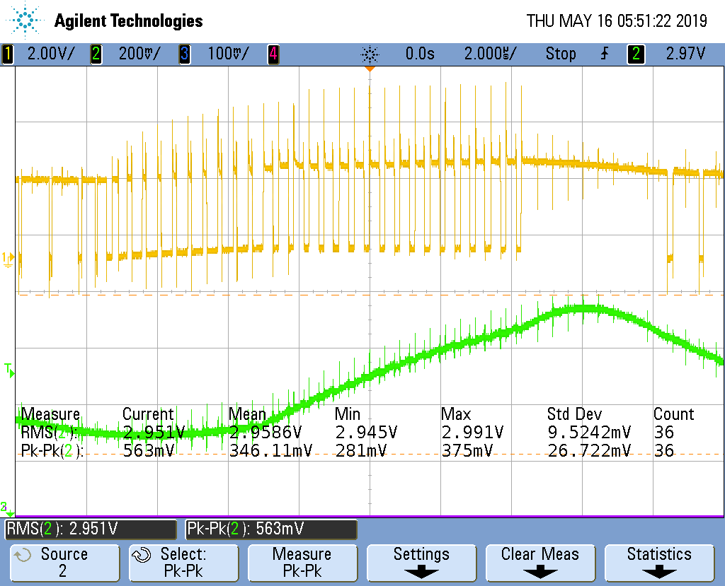

I need to convert  the TPS63020 into a constant-current source.  The reason for choosing the TPS63020 is that it is the only part I can find on Digikey or Mouser that is suitable for out application due to input voltage requirements and output voltage/current demands.    The way I want to do this conversion is to use a small sense resistor in series with the load and use the voltage generated across it as input to the INA138 current sense amplifier.  The INA138 has a transconductance of 200uA/V.   The output current from the INA138 can be used to generate the feedback voltage into the FB pin of the TPS63020.
I simulate the above condition in TINA-TI, and to the first order, it appears to work well.  A VCCS set to transconductance = 200uA/V is used to model the INA138 output;  this output current is converted to a feedback voltage via the 50k resistor.  With a 50m sense resistor, the TPS63020 will raise its output voltage to push exactly 1A of current through the load.  The load is just 2 LEDs in series here for the simulation purposes:
( The TPS63020 transient model was taken from TI's SpiceRack, fyi )
However on my physical TPS63020 circuit, on the actual PCB, with the exact same circuit except the VCCS is replaced by the INA138,  I see the output voltage output varies wildly. The input current also varies wildly, and when I probe the switch node I am seeing erratic behavior on duty cycle and even switching levels.  This I do not understand.  Some scope captures below (Yellow is switch node:   Green is output voltage) :
Can anybody from TI comment on what I am seeing when I probe these waveforms?  Why does it seem the TPS63020 cannot regulate in this configuration?
What can I do to adapt the TPS63020 to a constant-current source using the INA138 as my current-sense amplifier?   Could this be a control loop problem?    Is there a way to modify the control loop in the absence of an external compensation pin?

  • Hi Adam,
    I will assume that your PCB layout follows the recommendations from the datasheet. It isn't a bad idea to check the converter in voltage feedback mode - just add a resistor from FB to VOUT, and remove the INA circuit and the load. This way you will know that he problem is in the feedback path. Also I will assume that you are correctly using the INA138. If you are measuring current on the low side it might be that the common mode voltage is too low for the INA138.
    Otherwise, this looks like a control loop problem. I would try adding a capacitor in parallel with the 50 kΩ resistor, 100 pF for the start, and then increase it until the circuit is stable. If you have startup problems, put that capacitor from FB to VOUT instead of in parallel with the 50 kΩ resistor.

  • The issue is not fixed, it is not resolved.
    Something about this arrangement is causing instability and it seems it has to do with the feedback network.  TINA-TA shows no problem whatsoever but I imagine that the feedback network and error amplifier in the model does not reflect reality.  After a few days of experimentation, I  haven't been able to modify the feedback network to obtain a stable output in any case.
    As in the prior posting and screenshots, when I try to use current feedback as shown, the output widely oscillates
    I've tried (a) adding a 1k-10k resistor in series with the feedback pin  (b)  using a feed-forward capacitor anywhere from 1nF - 100nF  (c) adding a small filter cap 100pF-1nF on the current sense amp output to ground.  No success.   Trying to drive a 3V, 1A white LED with this arrangement results in large ripple in the output of 500mV or more and the input current also varies wildly.   However when I size the current sense resistor to provide about 200mA of current, the TPS63020 seems to regulate well and stable.
    Any other ideas?
  • I have not had any success with this arrangement.  The TPS63020 is unstable for my setpoint.  Trying to drive a 3V, 1A white LED with this arrangement results in wild oscillating excursions in the voltage output, of about 500mV or more, at a frequency of ~80kHz.   When I size the current sense resistor down to provide 200mA drive, the TPS63020 seems to be stable over its entire voltage range.
    I've tried to modify the external feedback network by either/or (1)  Adding a series resistor to the FB pin anywhere from 0.5k - 100k (2) adding a feed-forward capacitor from Vout to FB anywhere from 1nF - 100nF  (3) adding a small filter cap on the current sense output of 100pF-2nF    None of this works for the 1A/3V output case and the output wildly oscillates;  converter efficiency drops to 50% or below at this point as well.
    Any other ideas?  Any other illustrations or scope shots I can provide to help you see what is going on?  Can this converter even be used in this fashion?  I do not know about the topology of the internal error amp & feedback network.  It is likely that this converter used in this fashion will never be able to regulate successfully, but I want to make sure with you before I give up on the part.
