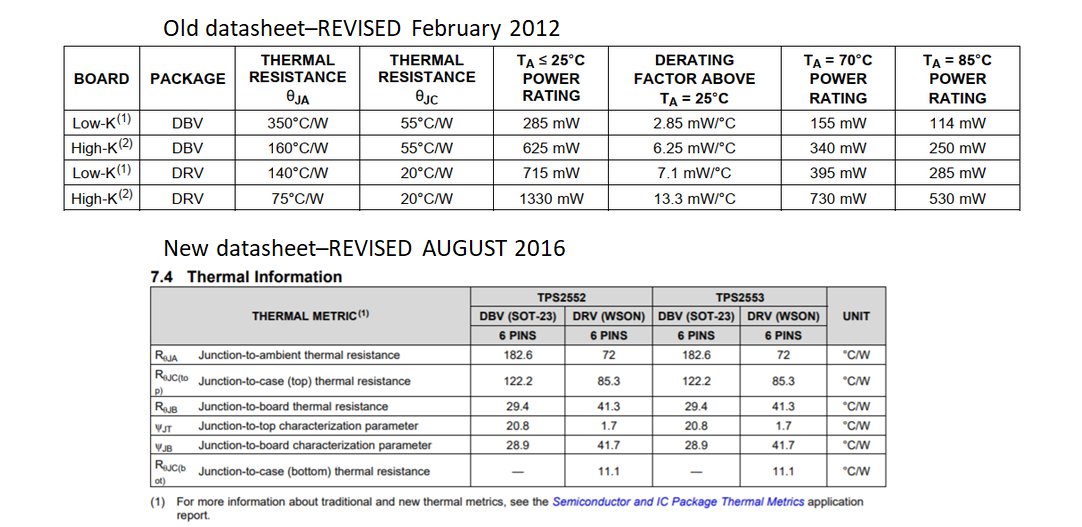

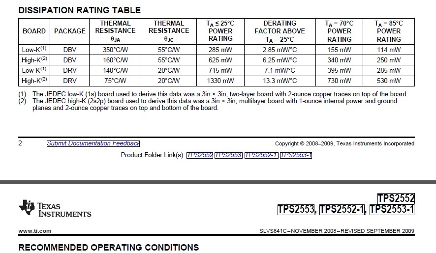

Our customer have a question about thermal information table.
In the revision C , we could find the dissipation rating table there.
But the revision F, only seeing the thermal information table at 7.4.
But it since like no description or notice in the change history.
Could we have your explanation about this change?
