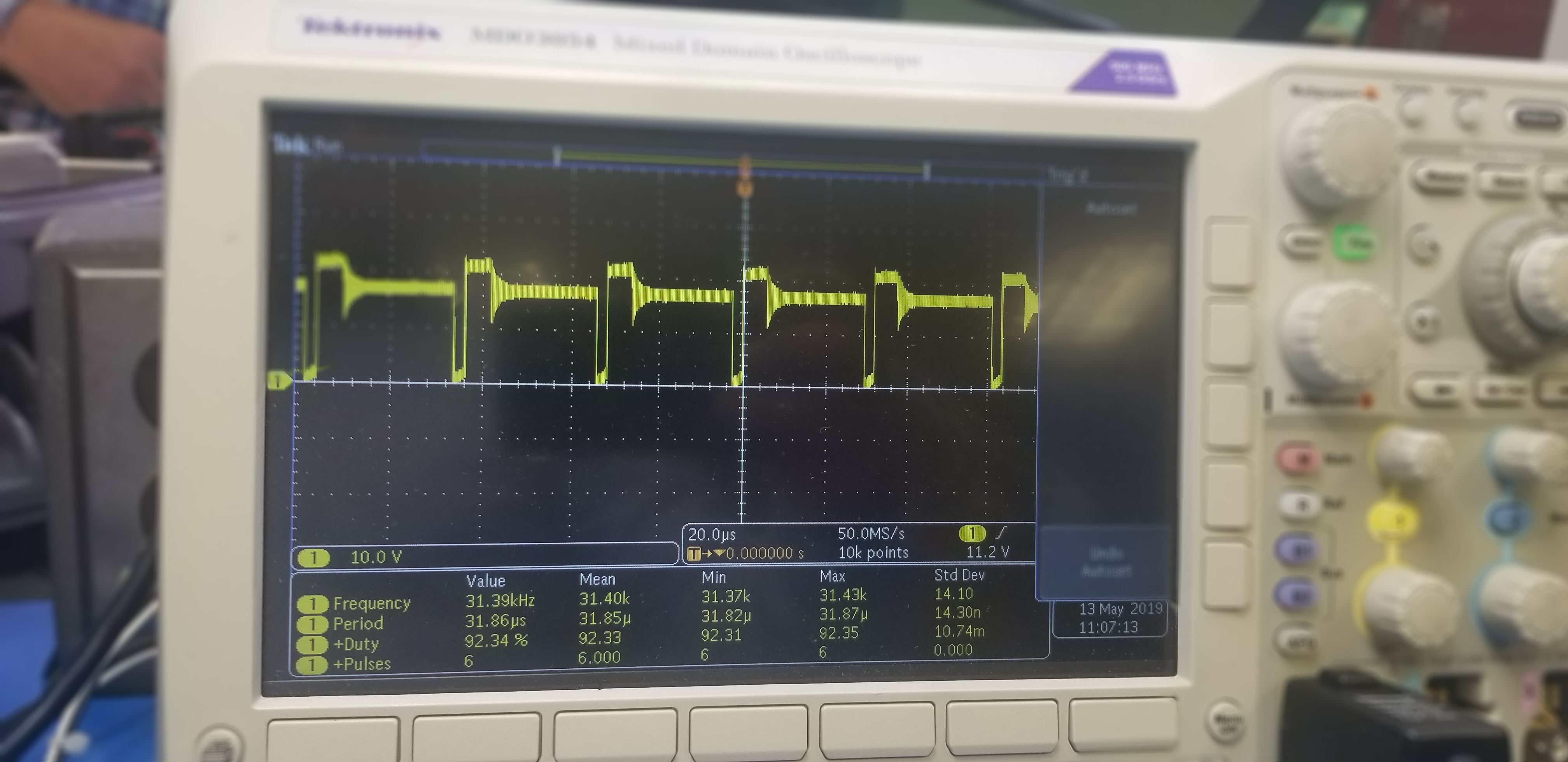

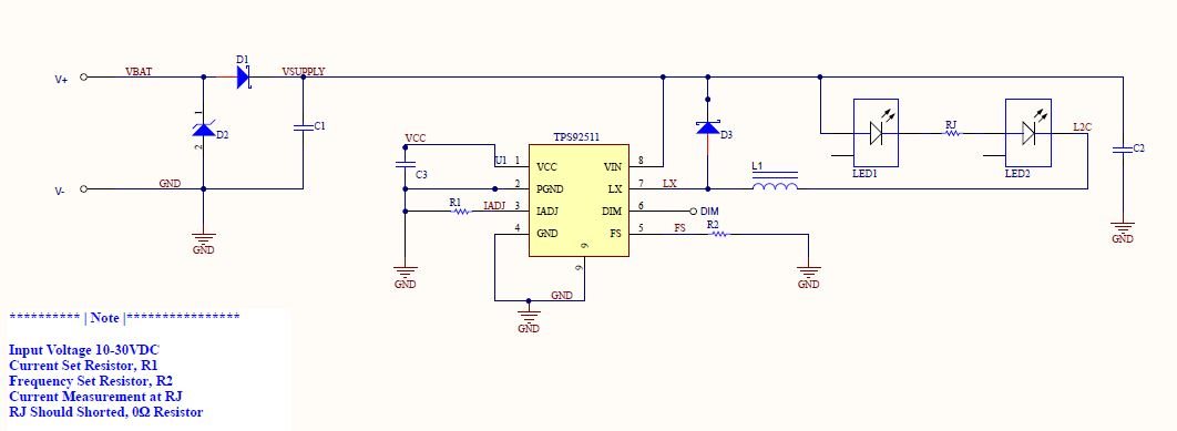

TPS92511: The Switching Wave from at LX pin Issue
Part Number: TPS92511
I have used TPS92511 for Driving two 3V LEDs at 350mA.
The Operating frequency was set as 300kHz using 33.2kHz Resistor
inductor used was 68uH.
The Switching waveforms at the LX pin doesn't seems to be perfect. There is some kind unwanted noise in it.
It would be helpful if some one can help in fixing this issue.
