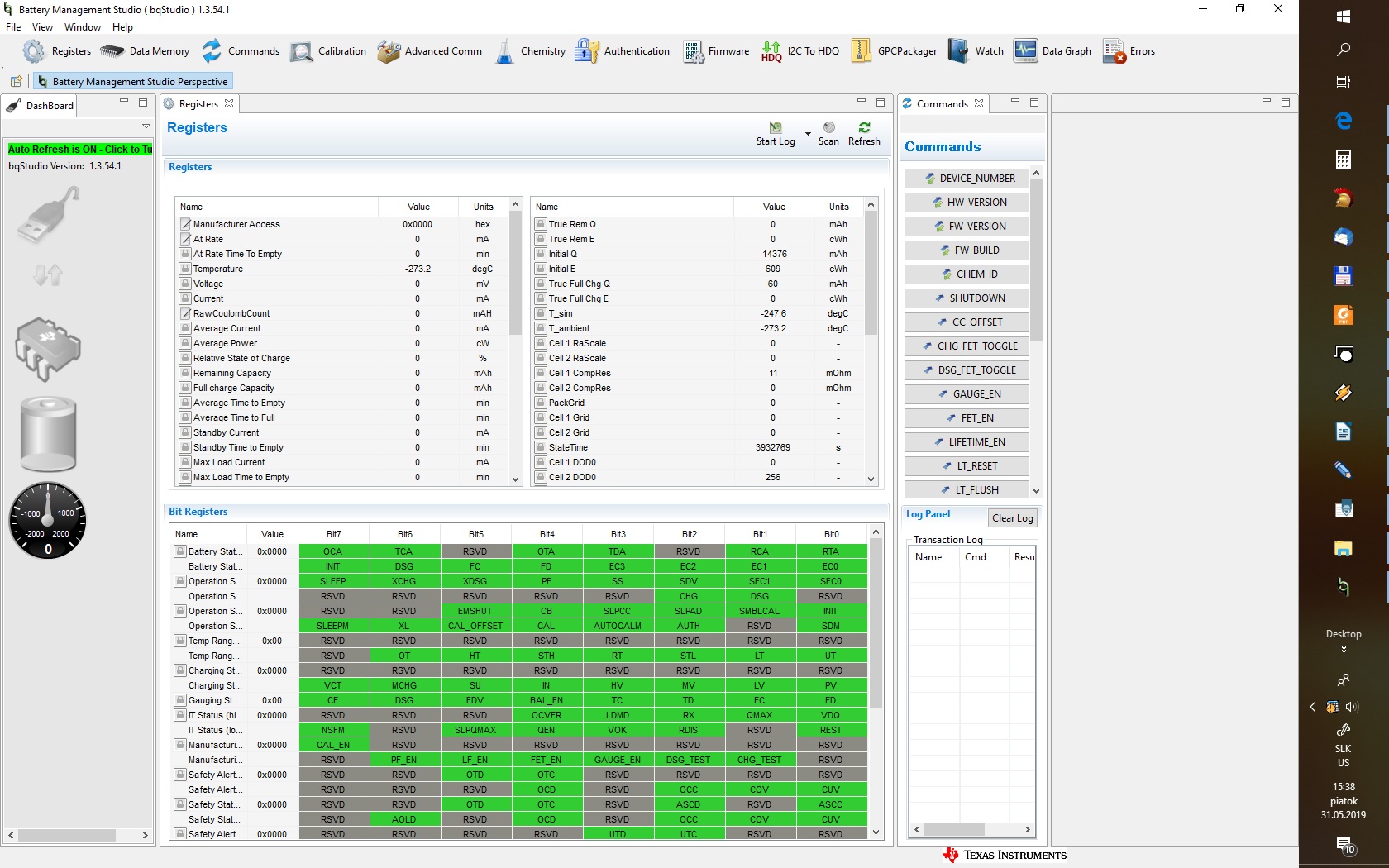

  • Hi Onyx,
    From where we can get dffs and bqfs files? We tried to process (program) srec file using FlashStream, but it doesn't work.
    Frantisek
  • You can get the bqfs and dffs files from the golden image plugin in bqstudio.
  • Hi Batt,
    If we select BQ78Z100, then Golden Image tab disappears from bqstudio. You mentioned plug-in for BQ78Z100, from where we shall download one
    Frantisek
  • This means that you may need an updated config file. I will have to confer with the fw developers to get it for you. Please allow me until Tuesday Jun 04 2019 to get back to you.
  • Frantisek,
    I should be able to get a file for you by tomorrow. The software developer is fixing the config to enable the feature for you.
  • Hi Frantisek,
    Please find the attached config file. Please copy it to your batterymanagementstudio\config folder and rename it to 1100_0_05-bq78z100.bqz.
