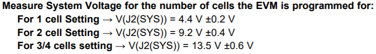

What I didn't understand is what is the SYS level after soft-start is over.
8.4V?
Vbat + little Drop-out?
thansk a lot in advance

    Here are the default register settings after POR. Some of the values you gave (such as the charge current) are incorrect, so please take note of that.
    To answer your question, VSYS should be around 9.2 V after POR for a 2-cell configuration. I confirmed this on an EVM and got the same result.

    the VSYS is 9.2V regardless if battery is connected or not, right?
    as this will supply the rest of circuitry, i want to be sure it is always there even if battery is removed

    Here's what I'm seeing on the BQ24773 EVM after plugging in the 20 V adapter. Keep in mind that my EVM is configured for 2-cell charging, and I didn't change any of the register values. There are 3 cases:
    1) No battery connected, then plug in 20 V adapter. VSYS = 9.09 V (due to MaxChargeVoltage register).
    2) Low voltage battery connected (VBAT < SYS_MIN), then plug in 20 V adapter. VSYS = 6.18 V (due to MinSystemVoltage register).
    3) High voltage battery connected (VBAT > SYS_MIN), then plug in 20 V adapter. VSYS = 9.09 V (due to MaxChargeVoltage register).
    Even with no battery connected, VSYS will still be regulated above SYS_MIN due to the NVDC architecture.
