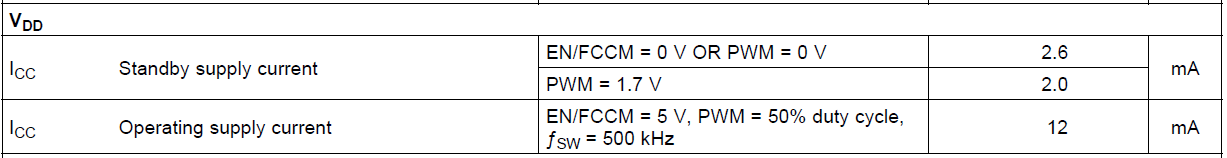

May I know the power consumption for the VDD pin.
The customer is wondering about the suitable LDO for all of the power stage.
Can I said one CSD95492QVM's consumption is 5V*12mA?

Hi Kevin,
Thanks for the question.
The current drawn from the VDD pin is dependent on the switching frequency of the device. There is a chart in the datasheet that plots this current versus switching frequency. After you have that, you can use P = VDD*IDD to calculate the nominal power requirement on your 5V rail.
