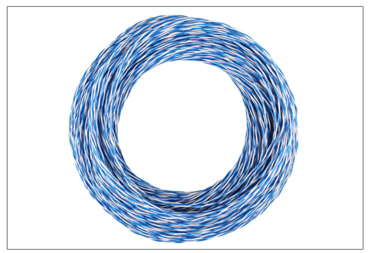

Can we use LAN cable for bq76PL455A daisy chain connection?

  • Hi Kohei-san,
    Here is cable we use for EVM.
    We don't verify other cables.
    SFI 23/18  twisted pair communication cable PR517-002 Krypton 17.3 100
    Centralized means all 455s are in one board, connecting devices by PCB traces.
    Thanks!
    Andy

  • Hi Kohei,
    I don't have its website also.
    Maybe you can contact your local trader.
    I also ever tried 0.5mm, oxygen free, pure copper UTP, 100MHz telephone wire. it also works.
    Thanks!
