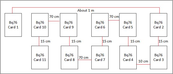

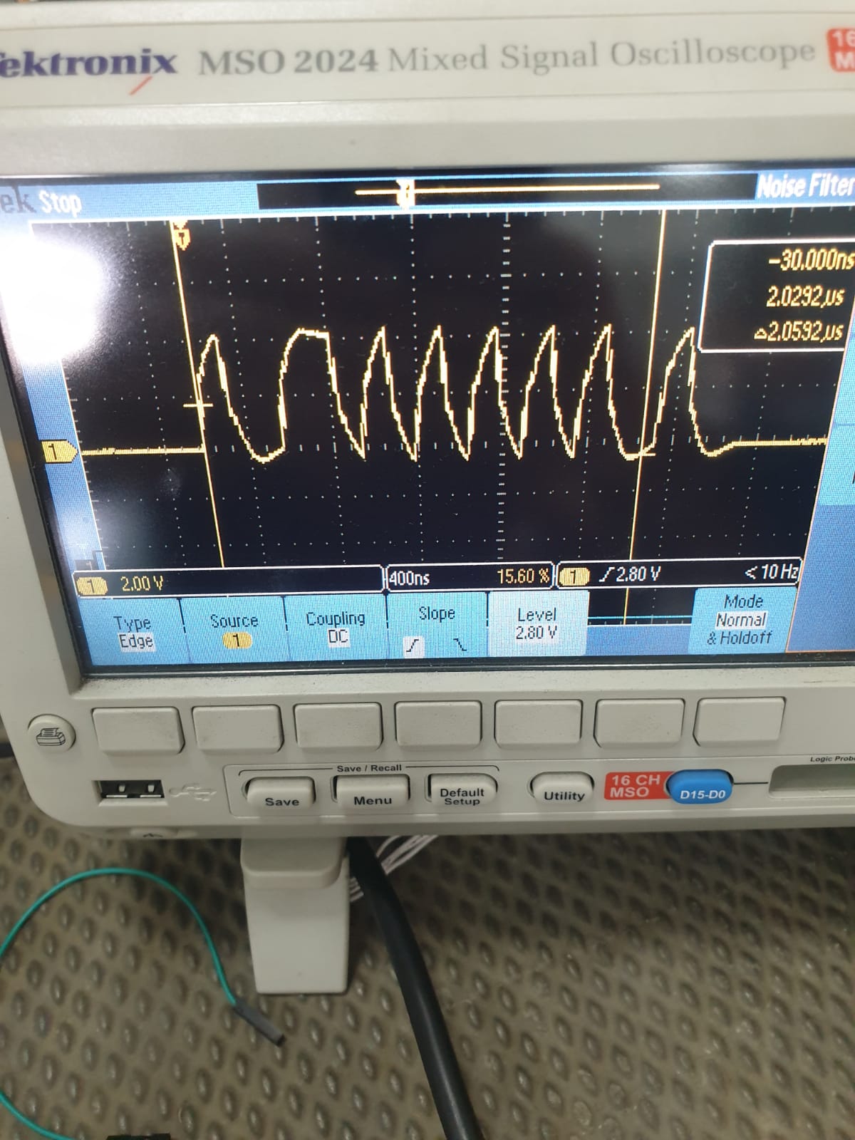

Hi, in our battery stack with 176 cells in series, we use one bms card based on bq76pl455 to read 16 cell voltages. Daisy chain communication is used between the devices. But when using auto addressing, some of the cards cannot take address. so we cannot communicate with them. When we measured the daisy chain communication channel with passive probe, we saw the following result. The cable capacitance seems high I think, but we cannot find a solution to this problem yet. Do you have a better document about the daisy chain comm design? Could you give us some suggestions to solve this issue.

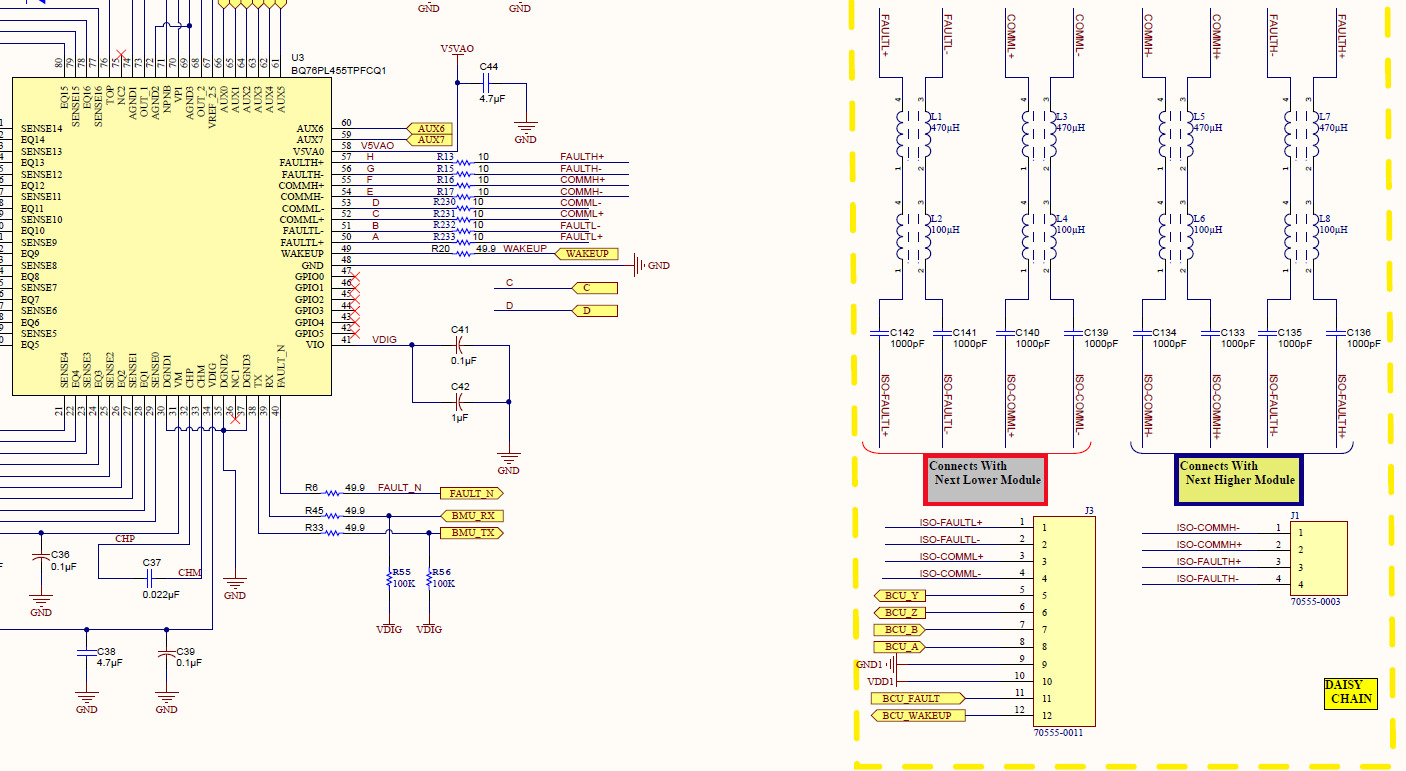

  • We have one master card with MCU on it, and 11 slave cards with bq76pl455. Master card communicates with first slave card over UART. Then daisy chain communication is used between other slave cards. In the daisy chain circuit, we use the design you recommended for noisy environments. There are two common mode filters and one capacitor at the daisy chain output.

  • Hi Taylor, I have given the details of our topology in my previous post. Yesterday, we got measurements directly from the COM input pins of bq76. When we measure the pulse widths at the last card of the daisy chain, we have seen that pulse widths are wider than it is expected. We are using a cable with a 30 pf/m which seems good. The total length of daisy chain cables starting from the first card to the eleventh card is approximately 3 meters or a bit longer. However, we cannot communicate with the last card in the network. I think it is the reason of cable capacitance. And also I must note that the isolation capacitors are 1 nF. We are planning to increase their values up to 2.2 nF but I think it will not solve the pulse width issue. Can you give me other suggestions for me to solve this communication problem? Thanks.

    The signal degrades when it passes over slave cards. And it cannot reach in a correct way to the last boards. After changing cable used in the daisy chain, we finally reached 10 of 11 slave cards. But we cannot communicate with the last one. We changed the last board if there will be a problem on it but nothing changed. When we looked at the COM lines at the last board bq76 inputs, pulse widths are higher than 125 ns. I think cable capacitance effects communication. We decided to increase the isolation capacitance value up to 2.2 pF.  But I think this will not solve pulse width problem.

    Yes I understand the description, but what I am looking for is the schematic to see if there is something going on or it just could be the equipment/cabling. If you have the schematic that would be very helpful otherwise we cannot debug this properly. I see that you mention that the total length is 3m across all boards so does that mean the daisy chain cable between each board is about 27cm?
    Taylor
  • Hi Taylor,
    Ok. I understood. Here is the schematic diagram of the communication part.
    And the pack cabling.
    Thanks for your help.

    I think we have solved the problem but not yet checked the system under real operating conditions. We increased the value of isolation capacitors and changed the cable with a low capacitance equivalent.

    Check the PL455A datasheet.
    You will see capacitance requirements.
    You will also find how to calculate total capacitances.
