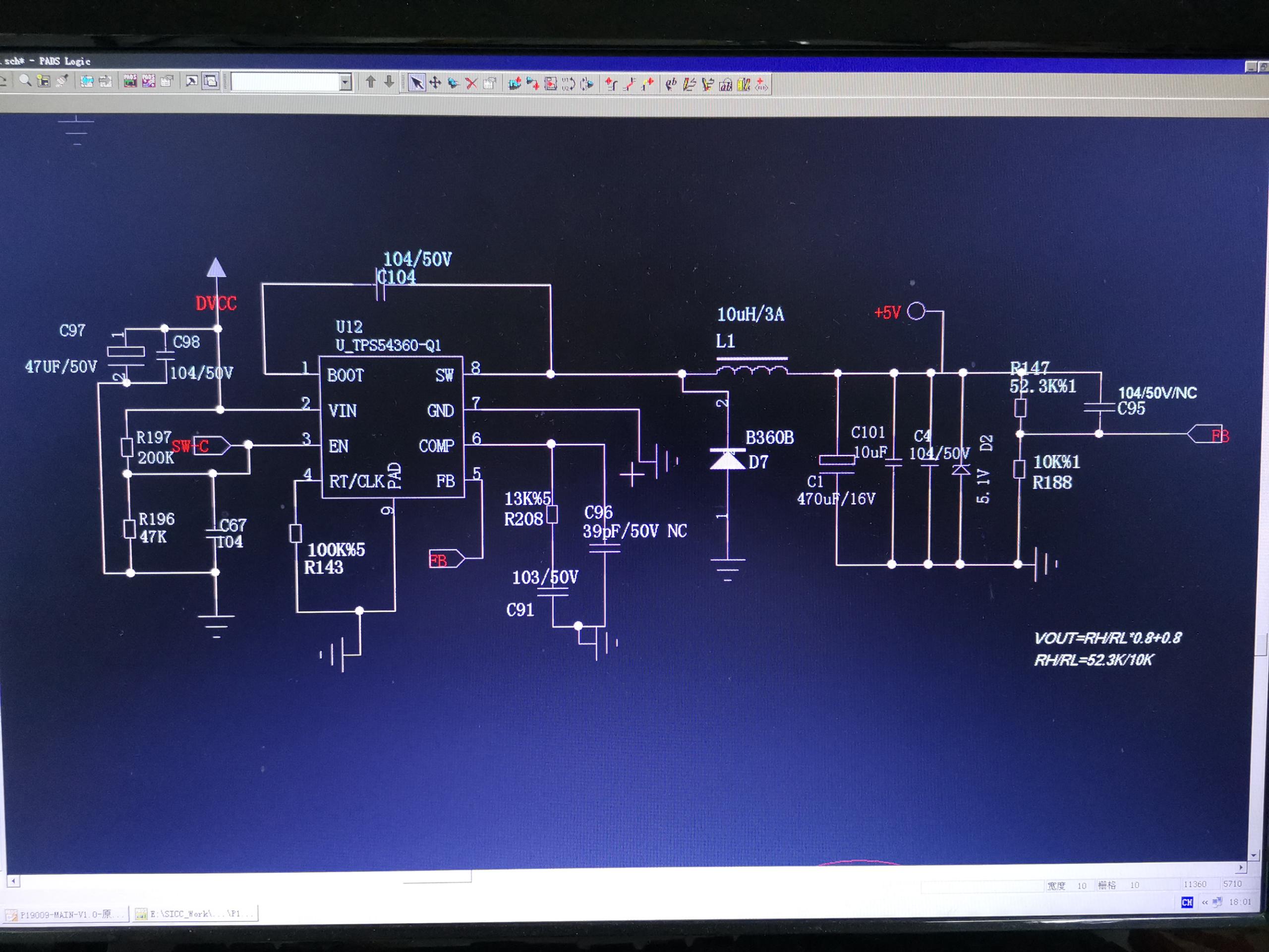

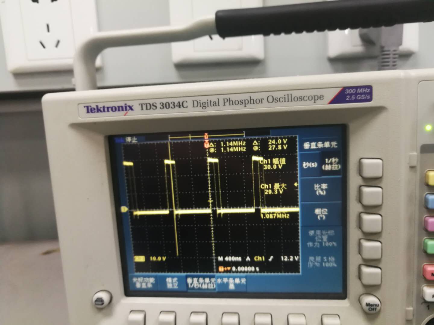

1. Phenomenon: TPS54360 is burnt out in the aging process(Vin=30V,Vout=5V/0.2A-2A) and abnormal impedance was found in Vin, Sw or EN pin
The Vin pin in particular has burned off. About 5pcs out of 100pcs were burnt out
2. Check and test found two problems:
A, IC BucK circuit is not stable, and the waveform of Sw foot is different in size (as shown below)
B. Input 30V  start up, Vout 5V/ 1.5a or above current test start up waveform, Vout overshoot up to 8.3v

  • Hello Jimmy,
    I would check the following:

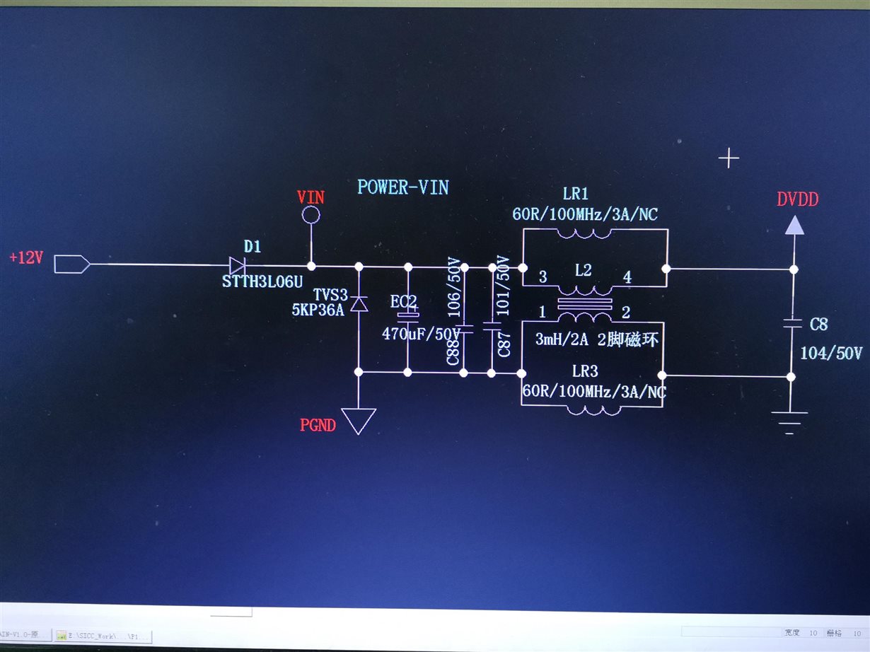

    1) Does the input of the part overshoot significantly when applying power? The common mode choke will have leakage inductance which may cause input voltage overshoot.
    2) In your oscillograms, it looks like the switch node undershoots below the IC’s Abs MAX rating for this pin. Depending upon which company’s B360B you are using, this may be minimized by diode selection. Layout may also affect this.
    Also, use of the TPS54360B series or, if your maximum input voltage is less than 42 V, the LMR14030 series may drastically reduce susceptibility to this type of noise.

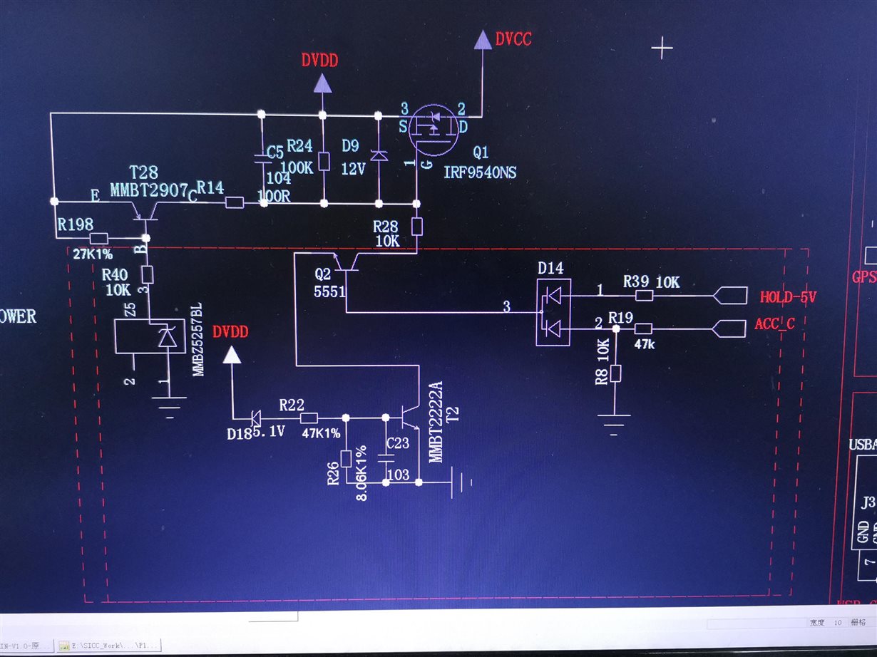

    3) SW-C in your schematic appears to come from off sheet. What is the maximum voltage that can appear on this node?
    Removal of the CFF, C95, is a good idea. Its value depends on the characteristics of C1. I can help with stability if you send the manufacturer’s part number for C1.

    1, SW-C no connect others ,only pull up resistor to VIN and pull down resistor  to GND
    2, C95 is NC
    3, the C1 and D7 datasheet as email to you

    Vin=30V, Start up test, In Room temperature
    CH1:SW
    CH2:EN
    CH3:Vin   Vout=5V/0.1A
    CH1:SW
    CH2:EN
    CH3:Vin   Vout=5V/0.5A
    CH1:SW
    CH2:EN
    CH3:Vin   Vout=5V/1A
    CH1:SW
    CH2:EN
    CH3:Vin   Vout=5V/2.5A

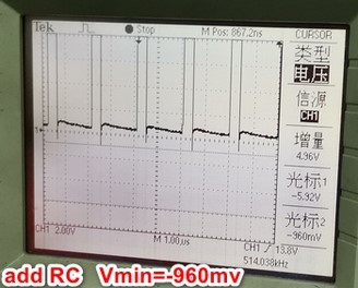

     1,Changed 1: remove capacitor C95;
    At that time, we found the phenomenon of large and small waves  in SW pin and made adjustment
    2,Changed 2: reduce switch frequency to 500KHz;
    Switch frequency is reduced from 1MHz to 500KHz to improve the problem of transient Vout overshooting when starting up and power up. At the same time, large switch frequency causes large losses of circuit components, so this adjustment is made.

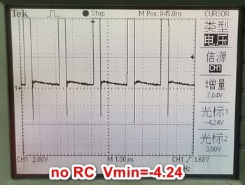

    3,Changed 3: add RC absorption circuit to absorb the shock wave at the foot of SW tube.(R=5R,C=4.7nF)
    The original TI factory pointed out in the email that the waveform on SW pin has abnormal undershoot, and suggested that we try the diode on EVM plate.After replacing the diode, the situation was not significantly improved. According to our experience, we added RC absorption circuit and observed the waveform change of SW.After adjusting the parameters of the resistance capacitance, the waveform of downrush is adjusted to a safe range.The figure below shows the comparison of SW waveforms before and after adding RC.
