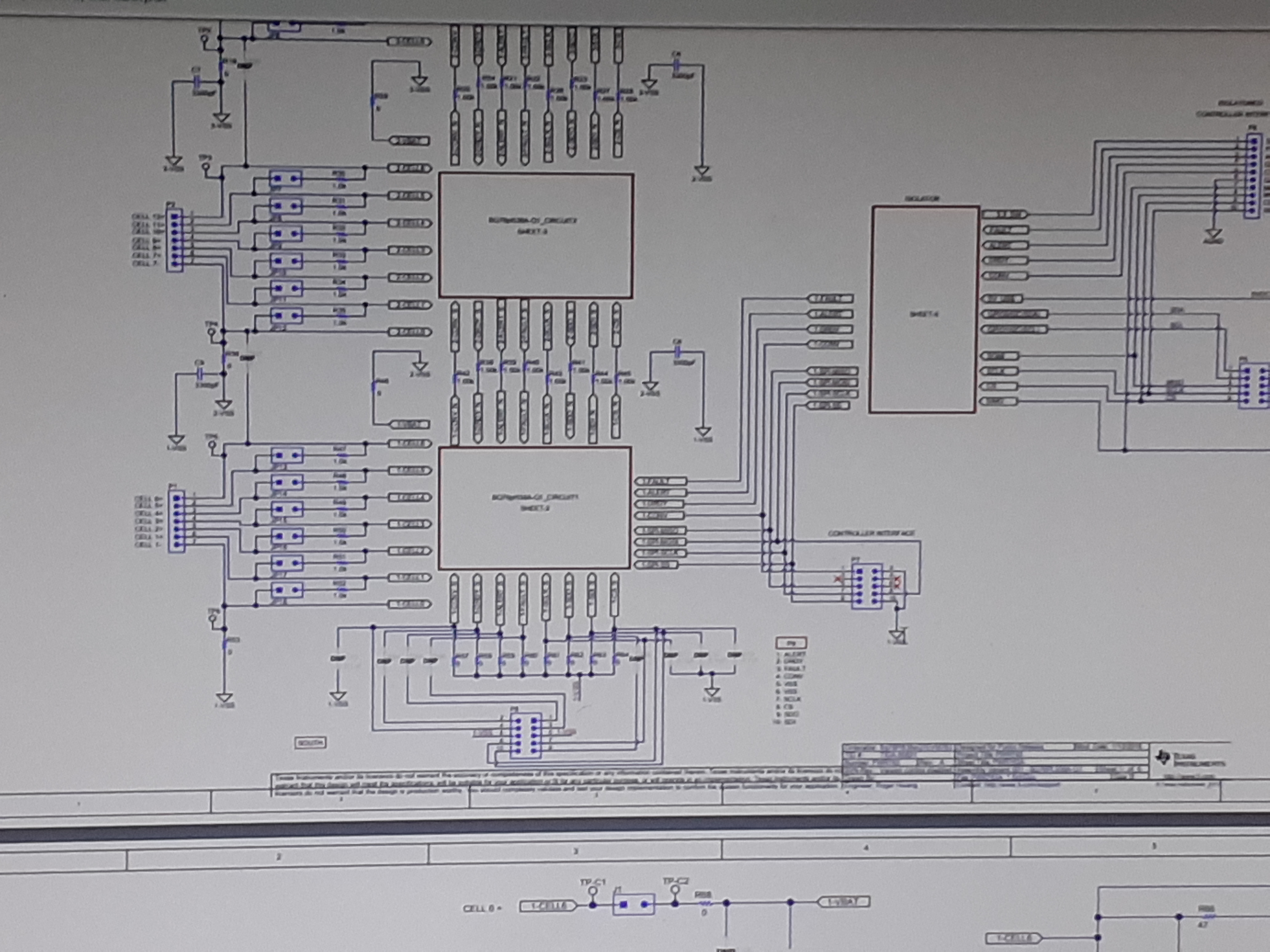

Please let me know how to control charging and discharging path break and how to design hardware circuit. please check COUT and DOUT pin for mosfet in path of battery negative and pack negative.8203.example.pdf
Hi Khan,
Yes, you can. Only thing to watch out is CONV_H.
If you use register to convert the ADC then float this pin.
Roger
