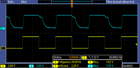

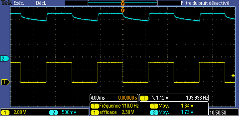

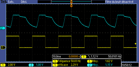

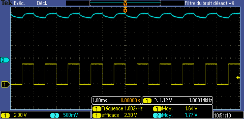

    No, I don't resolve the problem. I send you oscillo picture.
    The input voltage is 24Vdc. I have 0.1 V on the Iadj pin, and I have a frequency input on the PMW pin (between 0 and 3.3V), is the channel 1 (yellow)
    The channel 2 (blue) is the LED+ pin.
    So as you see, the frequency 20, 50, 110 and 1000 Hz are OK and at the frequency 80Hz (is the same between 70 and 100 Hz) the output is not the same as the input frequency.
    Have you an idea ?
    Best regards
  • Hello Delmas,
    What is your Vled/Vout? According to the oscilloscope pictures it's just over 1.5V. Notice on your 50 Hz picture it is not operating correct either. When told to turn on it doesn't right away. I'm guessing either Vboot or possibly Coff if your load voltage is very low. Can you get a picture of Vboot along with the SW node (so I can l see the boot voltage, it's the different of the two). Also I'd like to see the Coff pin.
    You can try increasing the boot capacitor value, say double, to see if it changes behavior.
    I'll probably be asking for a lot more information of your design, such as Roff, Coff, Vin, Vout, oscilloscope pictures of the output current at different operating points, etc.

    I try to increase Cboot to 0.3 µF and it solve my problem.
