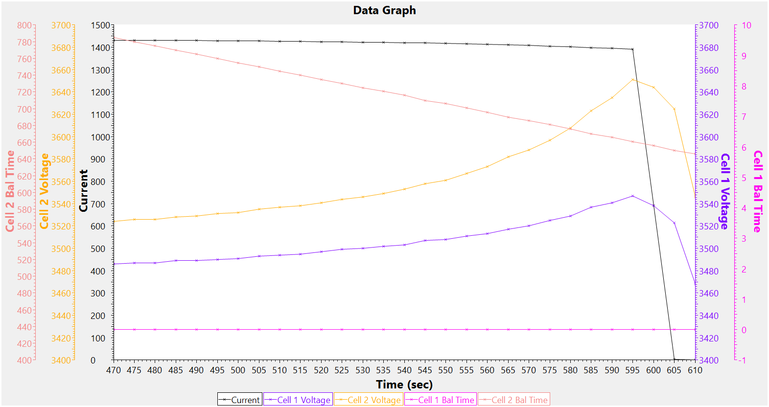

I've a problem with Cell Balancing during charging. I made 2 learning cycles and my UpdateStatus is 0x0E, so it should work. I can see OperationStatus()[CB] sometimes, when any Cell X Bal Time > 0, but these timers recalculate their values only after sending RESET command. So the main issue that cell disbalance > 100-400 mV at some time and charging is switching off (CUV = 1).

There's a graphic of charging:

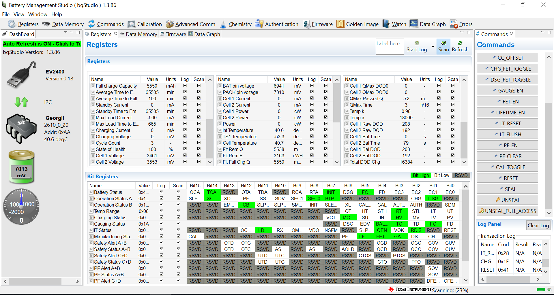

And Registers view:

    Our gauge performs cell balancing based on capacity difference between the two cells and not based on voltage. In order for cell balancing to work properly, you need to have learned successfully, which it appears you have so the qmax for both cells is accurate. Now afterwards, The device needs to take proper DOD0 measurement so as to calculate the delta q properly. You do not have to send the reset button as that forces a DOD measurement which could be wrong depending on oif the cells are relexed. You also need to enable the CB and CBR flags. See the TRM for additional details on cell balancing.

    I've already enabled CB and CBR flags since they are required for cell balancing, so the test was performed with these parameters.

  • I've noticed with oscilloscope that duty cycle of balancing FET is 20% and seems like this value is not enough. Can I increase duty cycle?
  • No, you don't need to. In this case you are using cell balancing internally. The gauge will take care of that.
