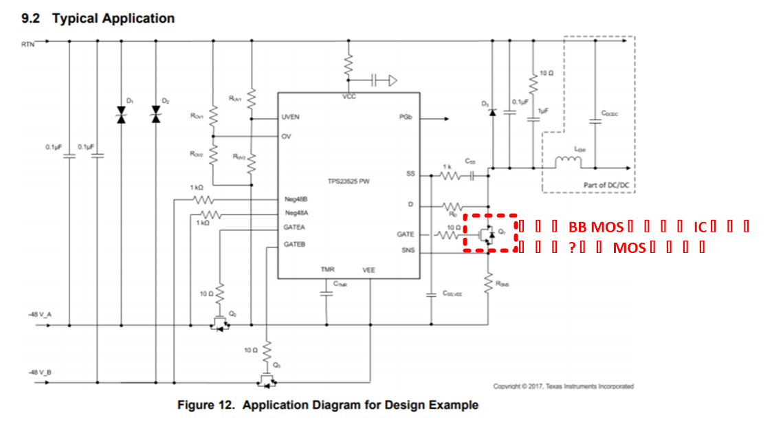

1.How to implement ENABLE function with this device?
2.What will the circuit response if the Q1 short circuit?
BR
Kevin
  • Hi Kevin,
    1. Please connect a NPN transistor between UVEN and VEE to implement ENABLE function
    2. if Q1 fails in short, there will not be any control on the power path. So, we will lose power path protection.
    Rakesh

     if Q1 short , how to protect?
    according to my experience on this application , the MOSFET is G-D-S short when it damage...
    then it will crush down the gate-driver source and lead to drive source of Q2, Q3 off.  then, Q2, Q3 wiil be heat due to full load.
    how to prevent ?

  • Hi Wang,
    Welcome to E2E!
    I understood your problem of failing IC (due to Q1 short) can subsequently lead to Q2, Q3 MOSFETs to fail.
    One way to overcome such situation is to use separate controllers for hot-swap and ORing function. For example, TPS23521 for Hot-swap and LM5051 for ORing. I would like to know under which conditions you expect Q1 MOSFET to fail. If we take care in design phase, Q1 fail can be avoided.
    PGb signal is to enable the load only after powering up the system. This is to reduce power stress on the Hot-swap MOSFET Q1 during startup. The PG signal inside TPS2352x device pulls low after powerup, which turns-ON the NPN transistor (refer Figure 14 in TPS23525 datasheet) which pulls up the EN pin voltage of the downstream DC/DC load.

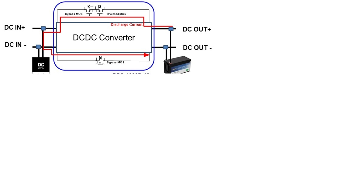

    i know your concern , and our application is not used in output oring function. i want to use TPS23525 appply to  bypass function showed as below.
    Bypass function are composed by Bypass MOS and Reverse MOS.
    i think thsi IC has a solution to deal with start up in battery discharge.
    DC Out(battery) is source and DC input(RRH). As DC battery charges the Cap of RRH , it must has a great current due to dv/dt  and without any resistance.
    the problem is RRH start up current, i don't know the RRH allowed how much load can endure at start.
    second , if reverse mos damage and lead to Bypass mos 's driver fail . it is very dangerours , it's not controllable.
    Do you have any ideal about this application?
  • Hi Wang,
    TPS2352x is low side controller. So, it cannot function to bypass the positive rail DC OUT+ to DC IN+.
    I suggest to use LM5069 (high side controller) with back-to-back connected MOSFETs as shown in app note www.ti.com/.../snva683.pdf
    The dv/dt control of LM5069 helps to limit inrush currents.
    May I know the reason to bypass the DCDC Converter ?
    Rakesh
