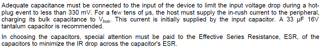

In datasheet p.10 Figure.22 Self-Powered Hub Per-Port Voltage Drop,
"Tantalum or 100µF electrolytic, per port"
33µF is tantalum and 100µF is ceramic capacitor.
Is this understanding correct?
    Means 33µF is tantalum and 100µF is electrolytic capacitor.

    Can we use the ceramic capacitor instead of 100µF electrolytic capacitor?
    Please tell us the value of ceramic capacitance if we can use the ceramic capacitor instead of 100µF electrolytic capacitor.

    The input capacitor is used for offering energy as hot-plug when the power switch and power supply can't response in such a short time.
    Due to the higher energy density of tantalum than electrolytic with same capacitor value, we can use bigger electrolytic capacitor(100uF) to replace with tantalum (33uF).
    From my experience, for power switch, 100uF ceramic capacitor is enough.
    But I can't guarantee for you about the part.
