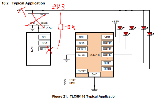

I have problems putting the TLC59116 into operation on my test setup. I have already oriented myself to this thread:
e2e.ti.com/.../720986
My wiring diagram is as follows:
And I have described the registers as follows in dezimal:

LEDOUT0=85
LEDOUT1=85
LEDOUT2=85
LEDOUT3=85
IREF=255
Unfortunately the LED's still don't light up. But what surprises me is the current. Initially it is at 9mA and after setting the register at 14mA. I have already described the registers according to the linked thread but also without effect.
But I get my ACK correctly and can read the registers accordingly. I already exchanged the IC.
Do you have an idea where I can still search?
