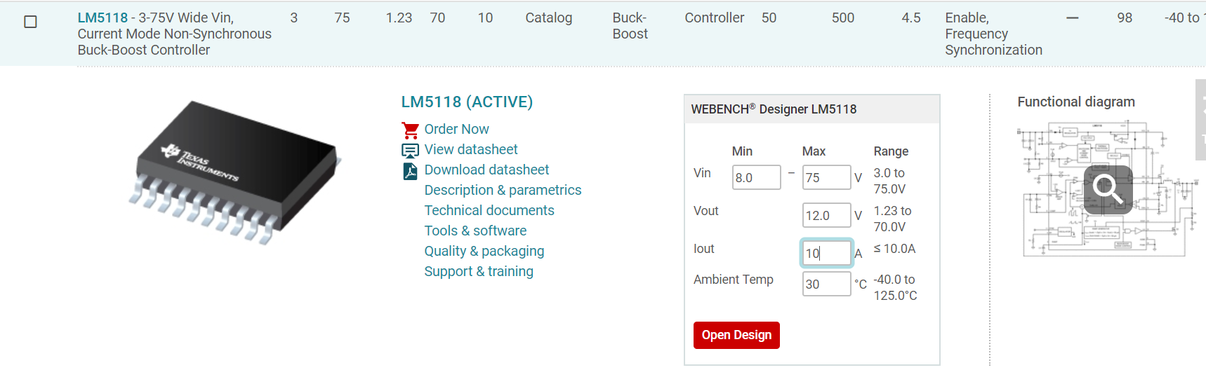

    1. Vin 7 - 60V
    2. Vout=12V, Iout=20A
Would you suggest the LM5118 for the customer's requirement?
I have used the webench to run the simulation. The result shows only Iout <10A. Would you suggest to use LM5118 for customer's spec?
Ben,
  • Hi Ben,
    Thank you for posting. This is up to 240W which is a stretch for a non-sync buck-boost. I would like to recommend the LM5176, and we have 300W ref design.
    60Vin is very close to the IC's max rating. Just make sure their 60Vin is a transient level.
