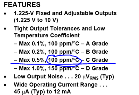

LM4041C12: LM4041C12IDCKR: what's the meaning of 100ppm/℃ ? where to check the Temperature Drift for Different Average Temperature Coefficients on 100ppm/℃ ?
Part Number: LM4041C12
Other Parts Discussed in Thread: LM4041-N
Hi
customer want to know:

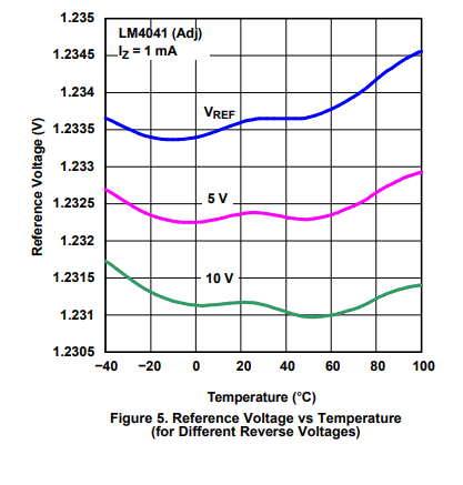

why reference voltage is so big offset from figure 1? but from figure 5, reference voltage offset drift is small, how to understand it?
thanks.
  • Hi Max,
    From looking at this old datasheet, it seems that this is a typo. This graph is suppose to have Reference Voltage (%) and not Reference Voltage (V).
    This graph is suppose to be similar to the graph on the LM4140-N datasheet.
    This is correct on the LM4140-N variant of the device.
    www.ti.com/.../lm4041-n-q1.pdf
    I would recommend to use the LM4041-N because it has more voltage options and variants that you can use.
