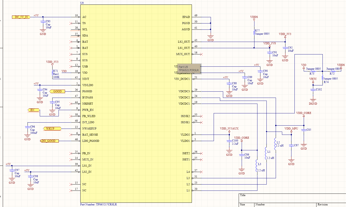

I have inherited a project since a team member left the company. I have just received the boards that were designed and noticed that the PMIC is not outputing any voltages. and the current consumption is 0.01A (apparently the PMIC is trying to do something but isn't able to).
After a review of the datasheet and the schematics this is what I noticed ... the SYS pins were left floating. According to the datasheet there are many pins that say "This pin must be connected to the SYS pin", so it's safe to assume that he made a mistake.
The thing is that I distinctly remember that the original person to design the board (another coleague who left) connected the sys pins together with the input 5V (the 5V that goes into AC pin) and of course the board didn't work properly, but I distinctly remember that in order to fix this and make the board work I took a box cutter and cut the connection between the sys pins and the 5 V input, isolating the SYS pins from the rest of the ciurcuit, just connecting them to each other and the board came to life (all those pins that require the 5 V were connected directly to the 5 V input).
I tried measuring one of its outputs (oin 20 connected to an inductor) and noticed that it tried to do something, it went up´to ~250 mV before going back to 0 V. This tells me that the PMIC is not dead, but there is something wrong.
Unfortunately this is not my project, I didn't design it, I was a member of the embedded software team, but now the hardware and embedded software teams are only 1 and now I have hardware responsabilities from designs that I didn't review nor designed. It seems that I have already answered my question ... that I probably need to cut up this board and do some wire ups to get it working, but i really need a second opinion before I start cutting anything.
If I go by my previous cut that isolated SYS pins from the rest of the circuit but left them connected to each other, then all I need to do is short those pins. But something tells me that I'm gonna have to cut many pins and wire everything up to get it working. Any advice?

  • Pablo,
    It would be helpful if you can share the schematic of this design, but the correct wiring of this device is shown on page 74 of the TPS65217 datasheet in Figure 60.
    A correct alternate wiring for when AC<=5V and there is no battery in the system (which would normally connect to BAT pins) is shown in Figure 62 on page 77.
    Either the main supply must connect to AC pin, and SYS pin connected to inputs of the voltage regulators (VIN_DCDCx, VIN_LDO, etc.) or the main supply (VIN<=5V) connects directly to BAT pin and the inputs to all the voltage regulators (while SYS pin must be terminated with a 4.7uF output capacitor).

  • Here is the schematic provided to me. It seems .. strange. Also I was measuring 1.8V on R73 ... which are pins 18 and 3 (VIO and VLDO1). Unfortunately I couldn't get to measure the other voltages.

  • Pablo,
    Based on the schematic, I would say trying to re-wire the +5V input from the AC pin to the BAT pins is your best bet, but there are a lot of issues that need to be addressed here.
    Even if you are able to cut the trace that connects +5V to AC and re-route the power to the BAT pins, you will at least need to do the following:
    1) Pull BAT_SENSE to GND through a 10k resistor.
    2) Connect a 4.7uF capacitor from SYS pins to GND.
    3) Solder a wire onto the PB_IN pin to be able to toggle it Hi-Lo-Hi to simulate a push-button press. In the final design, you would either need a physical push-button or to short PGOOD to PB_IN. Powering the PMIC from BAT instead of AC means you need a push-button press as a wake-up event.
    You can try to just do item #2. The system would power on, but I don't think the system will work very well over time. In other words, it may reset unexpectedly or get stuck during a power-cycle.
    There may be some other issues here that I am not aware of, but right now I just want the system to turn on and stay on for a few minutes.

  • If the +5V supply is routed directly to BAT pins, then shorting PGOOD to PB_IN should be sufficient to simulate a push-button press, as I mentioned in my previous reply.
