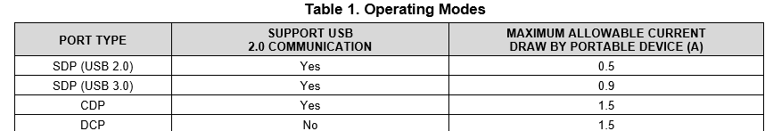

Hello
From Table 1 shows these Operating modes maximum current just 1.5A ,so how can I set to implement up to 2.5A output ? thanks
  • Hello Fandy,
    Non-compliant charging modes such as Divider 1, Divider 2, and 1.2V mode allow for higher current capabilities which the TPS2546 support. Putting the device in DCP_Auto mode will determine if a non-compliant portable device has been connected, and advertise the higher current options, one of which allows for 2.5A of current.

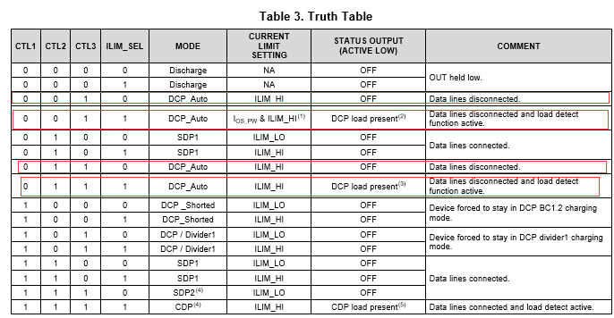

  • Hi Adam
    How to enter Divider 2 and 1.2V mode ?   it seems enter BC1.2 mode could through control CTR1,CTL2,CTL3
    I want to make output current up to 2.5A , refer equation1, set RILIM_HI  to 2.5A ? RILIM_LO set to what value ? I find Figure 40,Table4, max Iout is 2.5A,its RILIM_HI set to 2.97A

  • Fandy,
    The CTL pins control what state our device is in. Refer to Table 3 to determine what levels to put each CTL pin in order to enter into DCP_Auto mode.
    You can set the current limit to something higher in the event there are current spikes for brief periods of time that you want you system to be able to withstand.
  • Hello Adam
    so any one of below four config state all could provide 2.5A after set the limit exceed 2.5A ?
    one more question: Divider 1 mode could be provide how much current ?
  • Yes those configs are correct.
