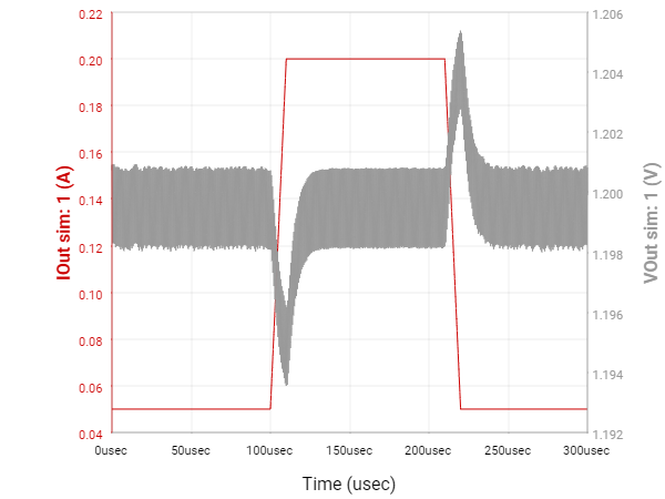

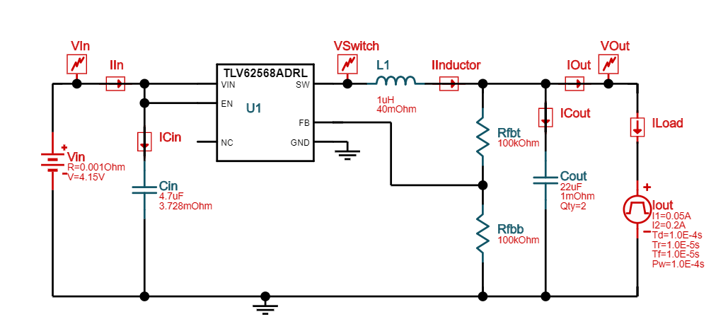

  • Hi C.T.,
    Transient load can be adjusted to the desired level in Webench although the min. current is 50mA. But step-load response has minimal change between 0A to 50mA (min load) because the device is always at PWM mode. Based on the simulation result, it has 20mVp-p output deviation. See below schematic diagram and transient load simulation result for your reference.
    Note: I suggest to add a capacitor option across Rfbt in the schematic diagram in case there is a need to optimize the step-load response in the future.

  • Hi Excel,
    Thank you, but I can get this result from Webench. My question is, I can't get any result like Figure23.
    Why the result from Webench is always lower than Figure23 very much. I don't know which one I should belive.
    So that is why I ask for the difference between Webench and Datasheet. Or the result difference is only at the 50mA min. load?

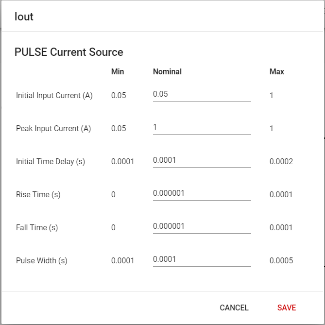

  • Hi C.T.,
    To have some short of align of the datasheet result vs. Webench, you need to adjust the rise and fall time of the pulse current source to 1us. This is to have the same current slew rate with the datasheet. However, because the whole circuit is simplified model to have fast simulation, it cannot 100% replicate the exact behavior of the system.
    Please see below pulse current source setting and transient load response (5.0Vin, 1.8Vout).

  • Hi Excel,
    Understand, thanks for your help, I found where I can modify the load parameter.
    Thank you very much!
