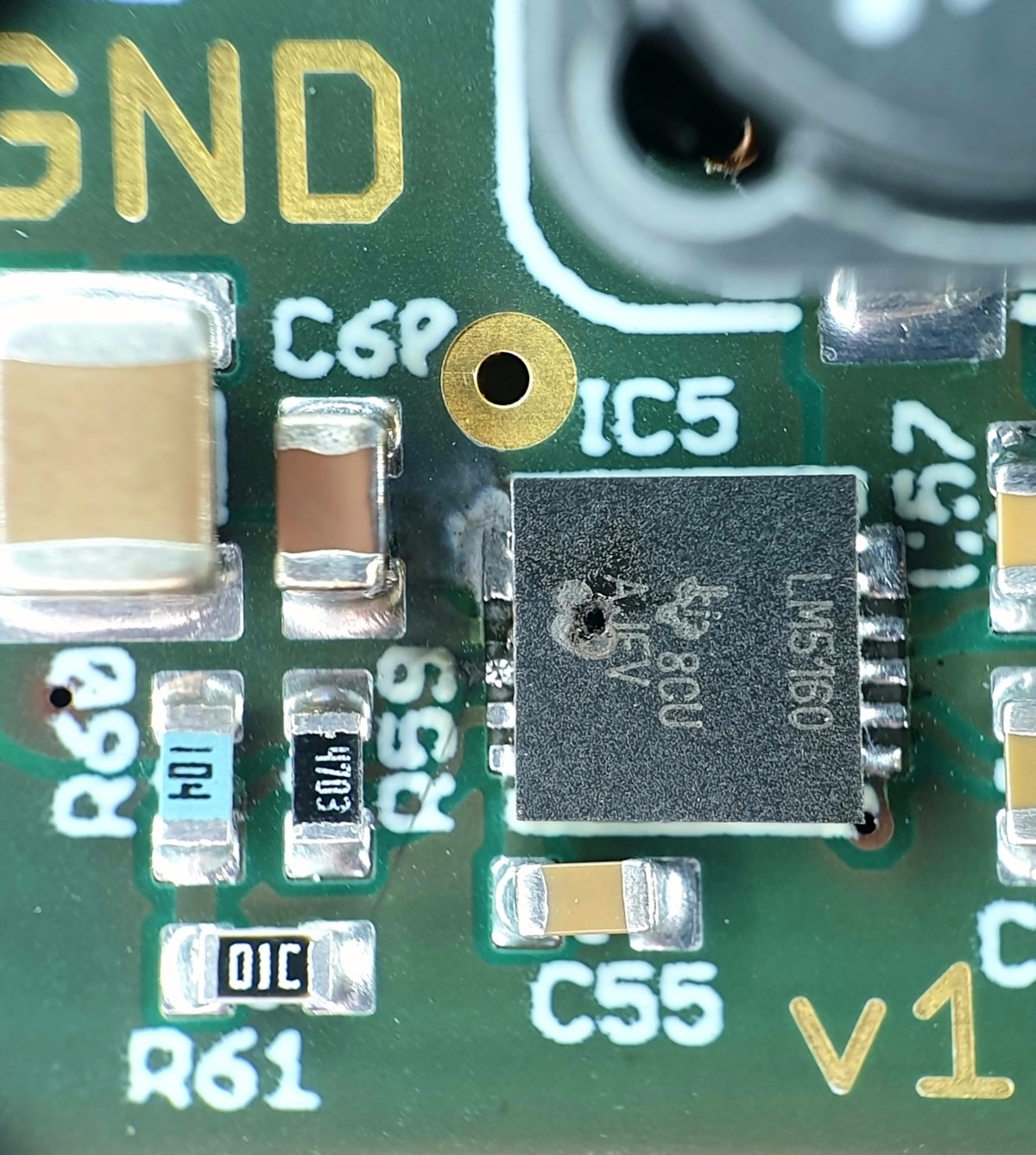

I designed small FlyBuck converter with LM5160A controller to generate a symmetrical supply rails from 50V DC source. I simulated the circuit and the simulation works well, but after creating small test-board I have hard time to get it run. Supplying the circuit from current limited bench power supply everything works well. Supplying the circuit from high power 50V power supply it burns directly :( Guys - what is here wrong??? Please see attached schematic and the photo showing where the IC burns - every time it burns exactly in this same point.

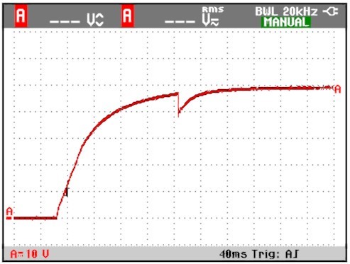

    thanks for your replay. I made some more tests and in total destroyed 4 of my 4 test boards... but, I made some more measurements. The first I checked the input voltage and unfortunately I cannot see any overshoot on the input :( Please see the screen shot below:
    The voltage is not measured on the input but directly on the power supply. The board was connected to the power supply with 15-20cm cables.
    The test circuit was destroyed exactly where you can see the voltage drop on the screen shot :(

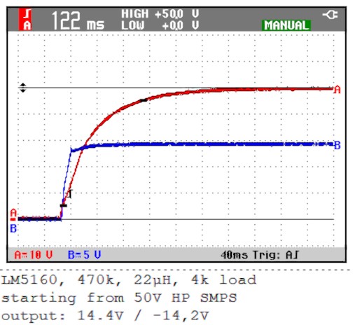

  • After some modification last board was working quite good and started without any additional capacitor on the input. I additionally loaded the output with 4k, 1k 500R resistor. See attached input and output voltage during the startup:
    Unfortunately after some time like 20min testing this board was also damaged. Once by start this same failure happens:
  • I would say there is no overshoot on the input and the inductor saturation current is rated way higher then maximal current of the LM5160... any other idea?
  • Hello Tomasz,
    If you depopulate D2 are you able to cause the device to fail?
    If removing D2 resolves the issue you can opt to leave depopulated, or I strongly suggest you either reduce the voltage on the primary to 12V and below, The VCC has an Abs max rating of 14V.
    Supplying a voltage to VCC causes strong gate drive currents which in turn causes high DV.DT to be seen at the VSW node.  This in turn causes excessive voltages, due to ringing at Vsw node, which can exceed VDS rating of the internal Devices.
    Hope this helps?

  • Hi David,
    Yes, indeed, this is what I also found, that the rating of VCC is 14V and my circuit gives slightly more than 14V. So first I depopulate the diode and I thought everything is good. I also adjusted the output voltage to 12.5V because 12.5V is actually the voltage I need - the circuit supplies TPA5532 amplifier. Unfortunately also this board failed after some time - it was the last one I had with LM5150A...
    I have one additional board wit LM5160-Q1 - different package and without the diode. The board works quite good and supplied since days my amplifier. I would say there is no differences between the boards with QFN and Q1 device and this is why I do not understand why this board works ok and all other boards are damaged :( Other difference is, the board with Q1 device gives slightly different voltage.

  • Hello Tomasz,
    The ringing as a result of stronger gate drive currents due to external VCC, is dependent on layout.  The layouts between the two boards are likely slightly different (even lead inductance between packages are different) and as a result can be the difference in robustness here?
    In short I believe that reducing the VCC voltage further or removing the diode that feeds the VCC is the best option in your case.  If you do not need to use the external VCC I would remove, as mentioned I would supply 12V (and not 12.5V) to the anode of the diode that feeds VCC so that VCC voltage is ~11.5V. If this is not possible, I advise to place a 5ohm resistor in series with C4, this will slow the DV/DT and reduce ringing and provide more robustness for your design.
    On a final note, I would not be supplying a VCC above the recommended 13V on VCC.  If you are even slightly above 14V (abs ax rating) you run a likely risk of damaging the device.
