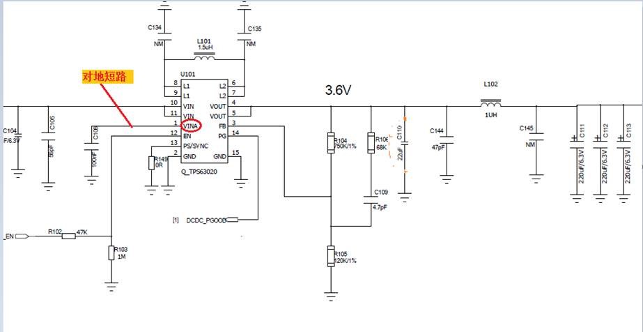

I have one customer used TPS63020, details application as below, they find one device VIAN pin is short to Ground.
vin:3V
output:3.6V
output current:100mA, it will be output 1.6A peak current when MT2503( base band IC) transmit in 700us.
pls refer below schematic, and provide suggestion what reason will lead this issue.
thanks.
details refer be low schematic
