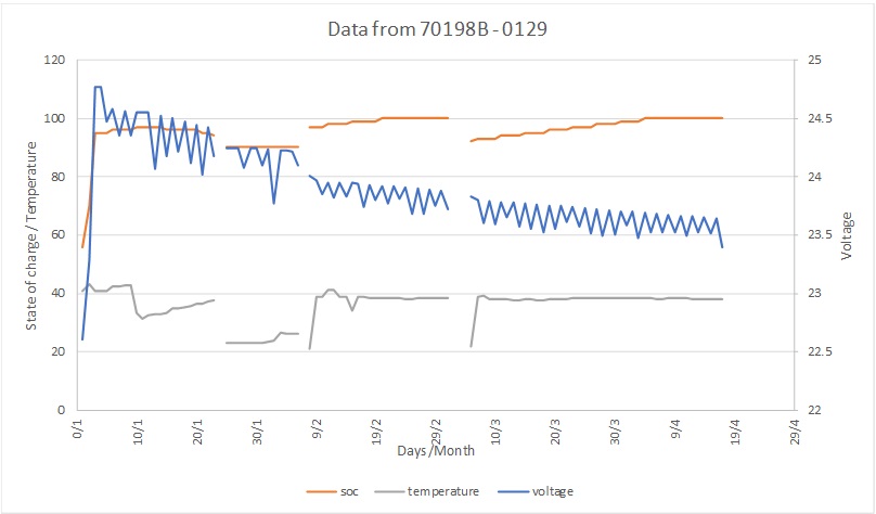

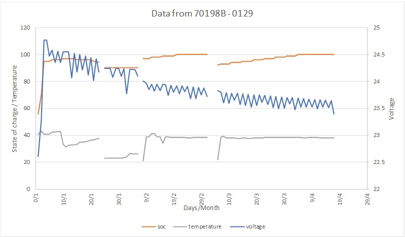

Hello everyone,
I contact you because we observe a strange behavoir: at some point the "Remaining Capacity" register increases during a discharge (without change for FCC register).

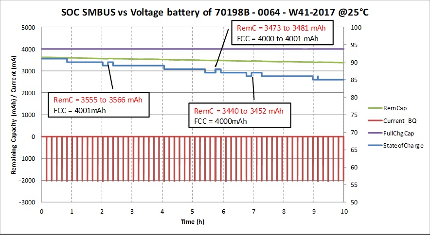

Here a curve of "DSG_10min_BQ2" file:
Remarks :
  • We discharge every 10 mins 2A for 7s.
  • Similar behavior had previously been observed (inversion of the remaining capacity). The cause was writing a negative value in the "Cc Delta" register. But the behavior was constant. In our case, what is strange is that it seems to be done in a hazardous way.
DSG_10min_BQ2.xlsx
For another battery, the voltage drops (there is a short discharge every day for months) and the SOC doesn't follow a logical behavior.
Vbat lower vs SOC higher...

The curve :
Our customer and ourselves do not understand this behavior. Can you explain it?
Best regards
  • I suspect that this is a result of capacity simulations during relaxation. The IT algorithm used here is old and has a few limitations. I will analyze your logs and get back to you with an answer this week.
    To add a few more elements here are the customer curves.
    3438.Extract-customer.docx
    3323.Document23.pdf
    Profile customer profile is as follows :
    -    The battery is discharged once a day during 5 seconds for a “Power Test Mode”.
    -    Discharge rate approx. 2 A
    -    Floating mode (only I2C communication) during the rest of the day
    -    Temperature (battery): 40 – 43 °C
    -    Battery is recharged if the SoC drops below 90%
    But as you can see, even after several discharges over the days, the SOC register can go down, as increase ...

  • Thank you Charles,
    I clearly see that the flags status of 0x281 is wrong. But that might possibly be a comm error. Can you please give me the details or your cell that you use and if you had generated a chem ID match for that?
    It is possible that a mismatch may cause issues with FCC. I don't see anything wrong with resimulated capacity, however IT requires at least a min passed chg for Qmax to be updated. In cases where this is not met, a relaxation time limit is imposed after which capacity is resimulated.
  • Hello Batt,
    • Why do you say that the value 0x0281 is an error? With this there are as flag : FC - OCVTAKEN - DSG.
    For me, it cannot to have together OCVTAKEN and DSG. Yet there is this value at each discharge.
    (FC flag because SOC = 100%)
    Sometimes, we have Flags() = 0x0180. In datasheet, I cannot find information about CF flag. What are the conditions ?
    • We use 0x1323 Chem ID (MP174565xtd).
    • Without charge, the algorithm is updated every 5h?
    Have you been able to study the problem?
    I come back to you comment: "The IT algorithm used here is old and has a few limitations."
    Is there more than one firmware for this component?
    It is still a shame to have a product already "old" for a component of less than 5 years... For information, the BQ20z95 we do not have this kind of miscalculation.
    To help you identify the problem, here are some new data:
    data3.zip
    Looking forward to reading you
    BR.
  • Thanks, Charles. I'm working with the fw developer here to understand your problem per your config. Allow me until tomorrow to respond to you.
  • Hi Batt,
    Have you been able to advance on the subject?
    Best regards.
  • Hi Charles,
    Here are some notes from the developer.
    It looks like this cell been characterized with a large margin of error. The cells DOD accuracy from the GPCCHEM tool for ID 1323 must probably be high. Your config has a large cell taper window that can cause issues with chg termination. Ideally that taper voltage should be 100mV from Vmax. Your window opens at 200mV. Please change that and retry your test.
    In fact, I saw that the Taper Voltage registry was too strong. We lowered it to 84mV.
    What annoys me a bit more, is the fact that our cell is not well characterized. Do you suggest characterizing the cells again?
    Something else. Reading your documents we found the Smooth function.
    In your opinion, can this help our case?
    Best regards.
  • Hi Charles,
    Yes, characterizing your cell might definitely help more than using smoothing. The reason is because smoothing has 2 anchor points at 100% and 0%. It will allow a jump to either from any value. That may not fully address the issue that you are seeing. The best way is to make sure that your chem ID is correct and that will allow your DOD and gauging to be better.
  • Hi Bat,
    I'm coming back to you about cell characterization.
    • Could you give us your procedure?
    • Can we do this study ourselves?
    • When you characterize cells, how do you judge it is performing well or not?
    Thank you for your support.
    Best regards.
    In addition, by pursuing our research, we have a new case.
    The following file explain the strange behavior in detail.
    strange behavior in storage.zip
    To sum up, the error seems to occur during a storage period. The circuit goes from 30% to 100% without charge or discharge.
    This error case is more due to a cell characterization error or the following parameters?
    • Learning Configuration of Table 28 instead of 29
      • Max Res Factor : 50
      • Min Res Factor : 1
      • Maximum Qmax Change : 96% (not 100%)
      • Max Res Scale : 32000
      • Min Res Scale : 1
    • Other point : SOH Load I : -20 instead of -400mA following TI
    Thank in advance.
  • Hi Charles,
    I believe it's a cell characterization error. Also, SOH load I should be set to what could possibly be your average load. This is because the state of health is evaluated using this current. The GPCCHEM page gives you information on how to get a chem ID for your cell. This needs to be done first. Once it's done, you can run a learning cycle similar to and characterize your cell.
