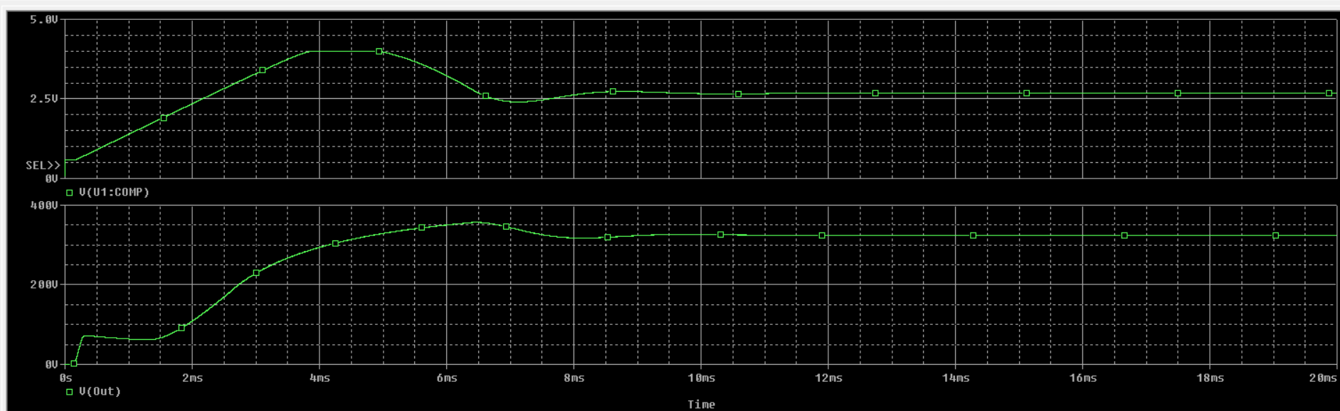

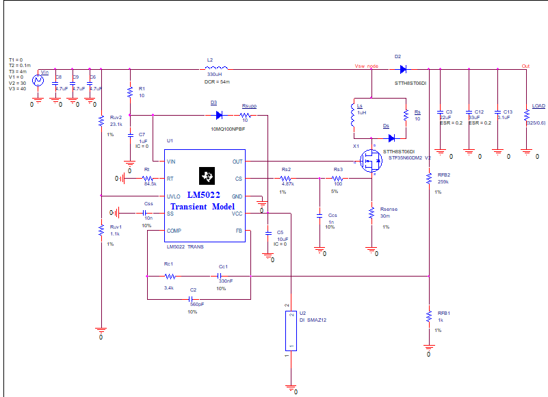

I designed a DC/DC Boost converter with the following characteristics:
Vin 30/40 V
Vout 325 V
Iout 0.6A
switching frequency 200 kHz
I used as IC, LM5022-Q1. I am not sure about the values of passive components of error compensation network. Since, I have, as you can see on the figure belows, a strange behaviour in the output voltage. Maybe, It occurs due to a mistake  during the analysis of the compensation.
I would really appreciate if someone could help me.
