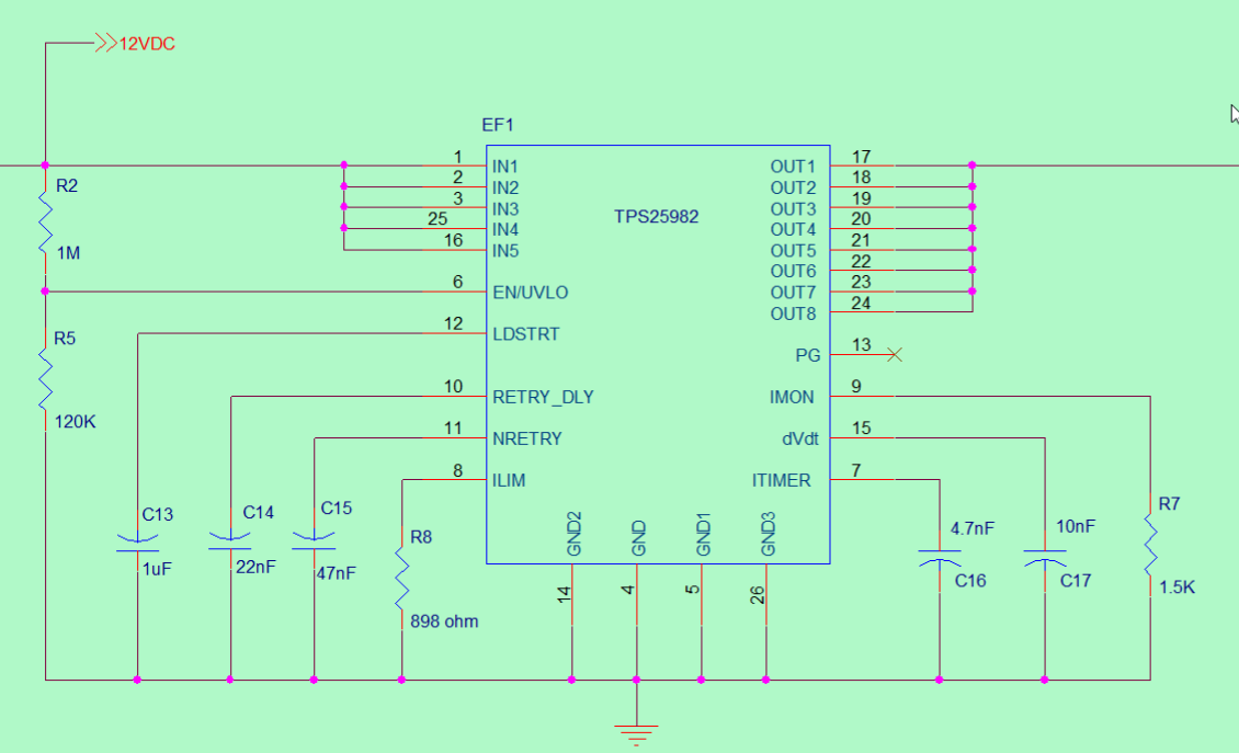

Hi Team,
Greetings for the day.
We are using TPS25982 e-fuse in my telecom application. I have implemented schematic as per your application note. i am not getting output once i switch on power supply.
Here is my schematic. Could you please explain me if i did any wrong in this?
