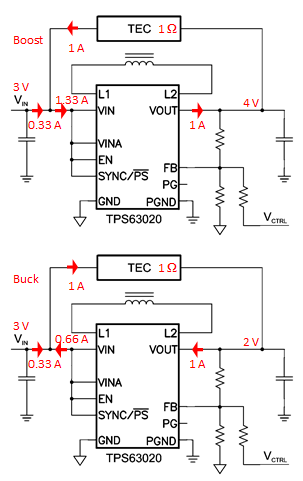

TPS63020: Sink current path when used as TEC driver
Part Number: TPS63020
Looking at SLVA677 Low-Power TEC Driver app note for the TPS63020 Boost/Buck converter,
This may be a very dumb question, but
I am unsure of the Sink current path when using the boost output
the VIN regulator can't sink current so  does it return back through the regulators input switch ?
