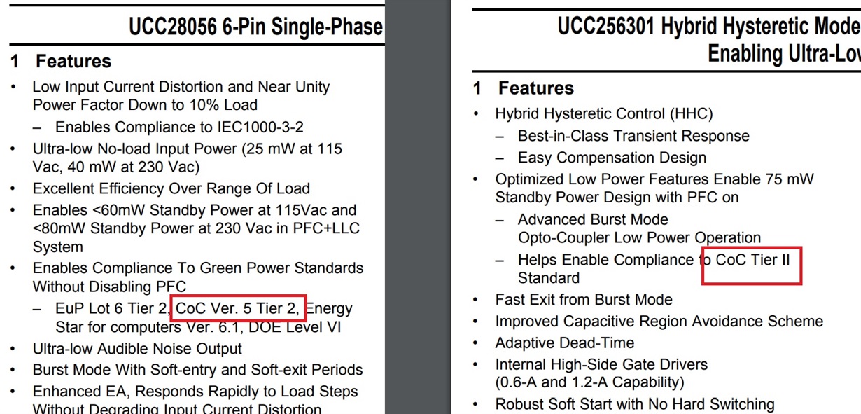

My CTMR ask AC90-264 to DC12V 160W condition,
Choose UCC28056 + UCC25630x can meet requirements of CoC V5 Tier 2 ?

UCC28056 will be in burst at light load. If need PFC off at light load, it requires external circuit (brown-out).
UCC256304 needs turn on first to bias UCC28056. UCC256304 can work without PFC in front but LLC topology is not good for the applications with wide input.
The 120V is usually corresponding to 85Vac.
