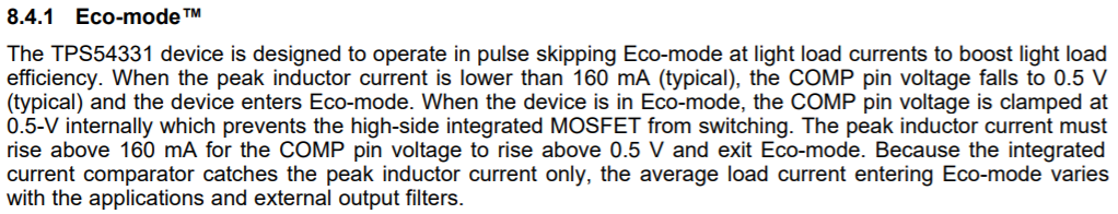

My customer is curious about pulse skipping Eco-mode of TPS54331,
we hope to know, it the device enter pulse skipping Eco-mode, how it works internally?
we have seen some description in the datasheet, but we are stil not so clear about this?
could you tell us more detail? we 'll appreciate you very much if you can show us some waveform to understand it.
