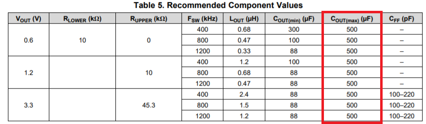

We found the recommended max. output capacitance is 500uF in datasheet.
Is there any potential risk if the application output capacitance exceeds 500uF? Thanks!

Hi Sam,
The output capacitance will affect the LC double pole in frequency domain. Large capacitance result in lower double pole frequency. The loop may not have enough phase margin to keep it stable. Thanks!
