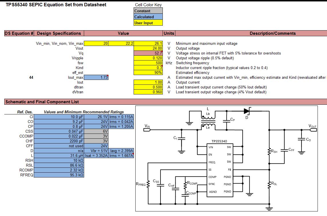

I want to get a recommendation of DC/DC application as below:
Vin = VBAT from 6S1P battery input
Vout = 24V with 1A max.
I can find several candidate. But I want to get cost effective and proper to our application.
Thank you for your recommendation.
But when I search component with WEBENCH DESIGN CENTER, it didn't recommend TPS55340.
Search condition
Input DC 5V-30V
Output 24V at 1A
Temp 30C
Result shows such as LM25188/LM5118/LM34936/LM5176.
And when I see EVM document, it just accepts 6V to 18V of VIN.
When I tried to follow detailed design procedure from DS, webench interactive preview doesn't show solution with this requirement.
I want to know what is difference in circuit when VIN is changed from 6-18V to 20-26V
Actually VIN is planned to use 6S1P battery voltage.
VBAT will varies 20V to 26.1V
Can I use TPS55340 EVM kit to test our application?
During review of TPS55340 EVM, I found a question and answer related to VIN voltage and IOUT.
http://www.ti.com/tool/TPS55340EVM-017
https://e2e.ti.com/support/power-management/f/196/p/796838/2947865#2947865?jktype=e2e
Junghwa
Dear Sir,
you just need to change the upper side dividing resistor, please change it to 187k.
When I checked the value with TPS55340_SEPIC_CALCTOOL_v1p1.xls from you website, it shows different result.
RSH doesn't change by VIN and VOUT change.
It looks that you need to modify G107 cell value from absolute number of 86600 to "=F106".
Please review TPS55340_SEPIC_CALCTOOL_v1p1.xls and revise it.
