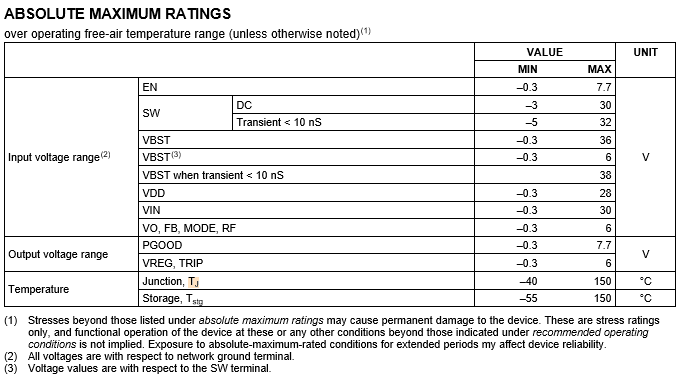

Tps53515 has a technical parameter trouble to help confirm, the recommended junction temperature Tj maximum to how many degrees?
The ambient temperature of the recommended work is only 85 degrees, but we hope to have a more accurate junction temperature Tj information, what is the recommended working range?
