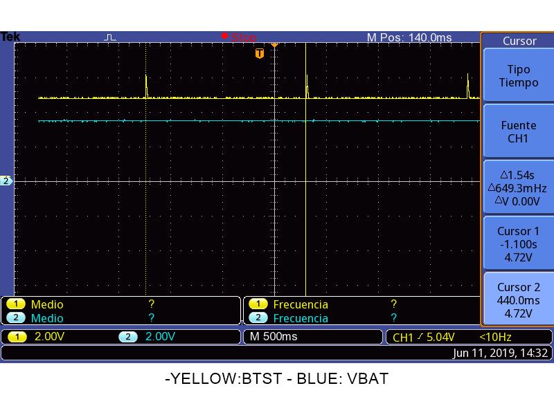

Dear all,
We are working on a device that can be charged at 5V or with solar panel with the BQ24650. We already made a few prototypes in the circuit that we had designed worked correctly charging at 5V 2A.
These days we have ordered the pcb already assembled and our surprise is that the device can no longer charge to 5V. You need 5.3V to 5.5V to start charging.
I have taken captures and made measurements of all parameters and the only difference I have found is here.

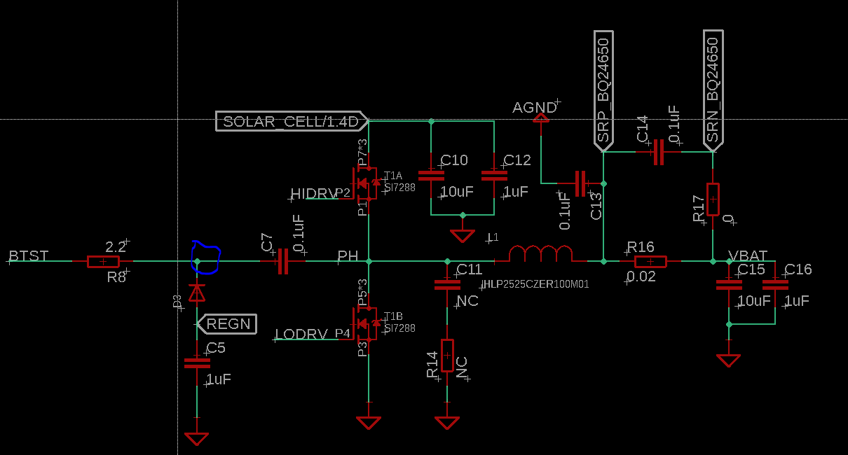

The measurement point of the picture in my schematic:
The design is based on BQ24650RVM-639 and we did some changes in VMPPSET=4V and also VBat=4.2V.
Any clue what could happen?

    Bq24650_Sch.pdf

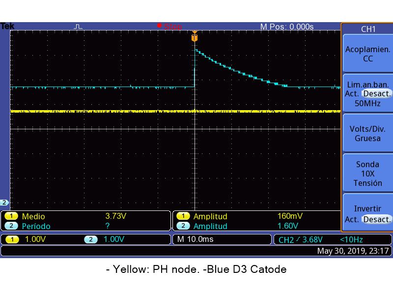

    Secondly, I've taken some caps of PCB2 in my oscilloscope.
    As you can see in my first post, BTST send "ramps" periodically, however PH node doesn't change.

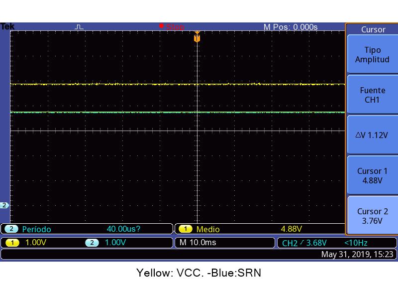

    In the picture below you can see VCC & SRN:.

    In the next picture you can see the "ramps" in BTST node
    With Vbat=3.43V the device begin to charge at Vcc=5.26V in my power supply and the btst send ramps each 1.5s aprox.
    Should I supose the device is in SLEEPING MODE?
        From the test results, BQ24650 is not in sleep mode as the condition for SLEEP is VCC-SRN < 500mV. Make sure to measure VCC and SRN on the respective pins of the IC. Your REGN voltage is a lot lower than is specified for this IC and should be between 5.7V and 6.3V with a typical value of 6V. REGN is used to drive the HSFET and LSFET. Can you check for the value of REGN on the boards of yours that were working? If REGN is so low it means IC could have been damaged. Try replacing the IC on failing boards, as well once you have measured REGN on passing boards.
