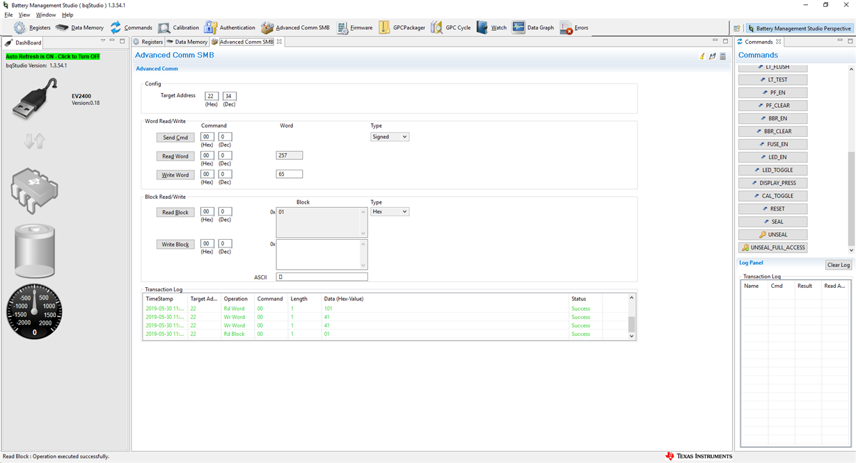

The device is no longer able to communicate within the battery management studio.  How do I undo this? I'm assuming I have to send a series of commands through the Advanced Comm SMB tab?  Can you please outline those commands or provide another solution?

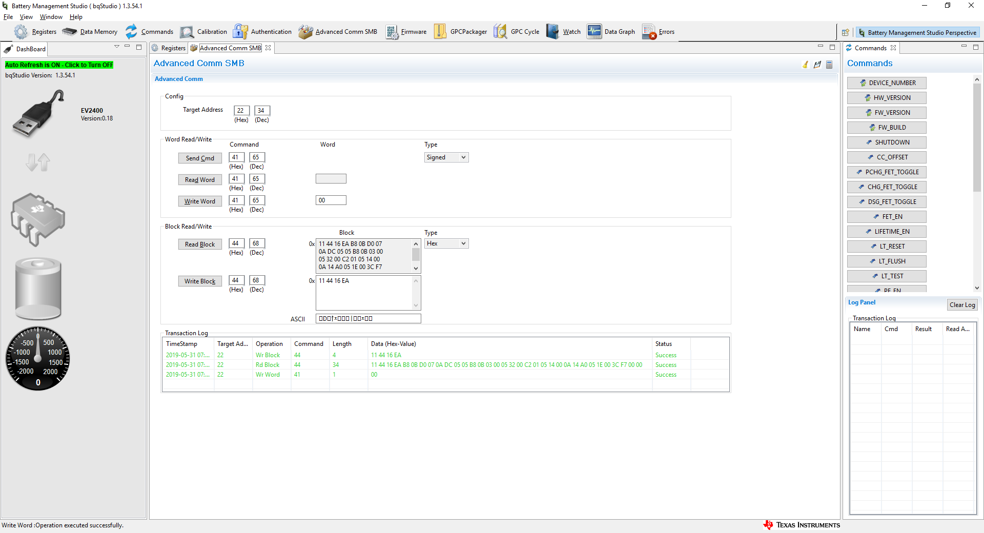

  • Please do a block write to address 22 now, the write should be done to register 0x4411 with data 0x16 and 0x4412 with data 0xea. These are the address and address check registers. Then you reset the gauge and it will respond back at 0x16.

  • Ok I write the block as follows:
    44(hex) 68(dec)       Block => 0x 11 44 16 EA
    I then Read the block:
    44(hex) 68(dec)  Block=> 11 44 16 EA B8 0B D0 07
                                                   0A DC 05 05 B8 0B 03 00
                                                   05 32 00 C2 01 05 14 00
                                                   0A 14 A0 05 1E 00 3C F7
    I can see the address and address check have changed to the desired values
    Now under "Word Read/Write" I write word 41(hex) 65(dec) to Reset the device but it does not reset.
    I also block write 41(hex) 65(dec) to try and reset the device but it does not reset...What am I missing? (See Screenshot below)
  • Nevermind....Issue has been resolved.
    I had to perform a final Write Block to Reset the device as follows:
    Write Block 44(hex) 68(dec)
    Block => 0x 41 00
