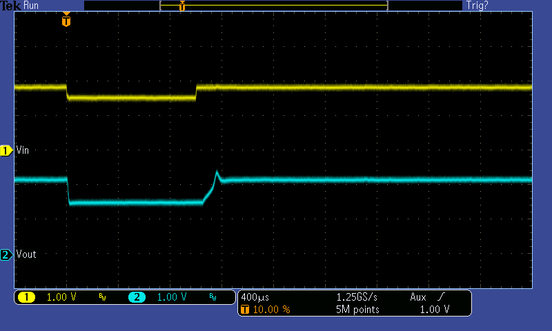

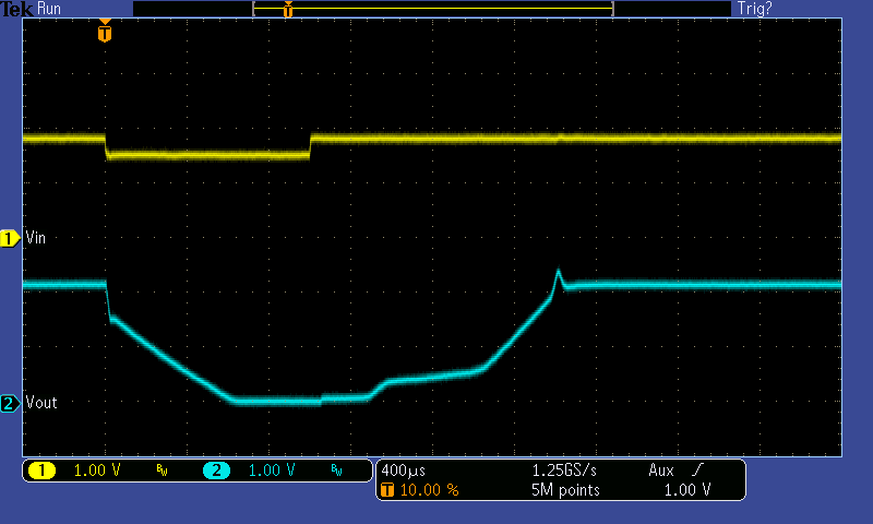

    Sorry for the delay. If I understood correctly, the input voltage drops to 1.5 V, for the duration of 1 ms. If so, this pulse duration is too long, the UVLO will be triggered and turn off the device. Here are two examples:
    Vin=1.8 V, Vout=2.1 V, Iout=0 mA:
    Vin=1.8 V, Vout=2.1 V, Iout=50 mA:
    There is no easy workaround, the device simply cannot operate at Vin=1.5 V. If this voltage drop is caused because the battery is not strong enough, then you either need a stronger battery, or enough input capacitance to cover the load spike for a short time.
