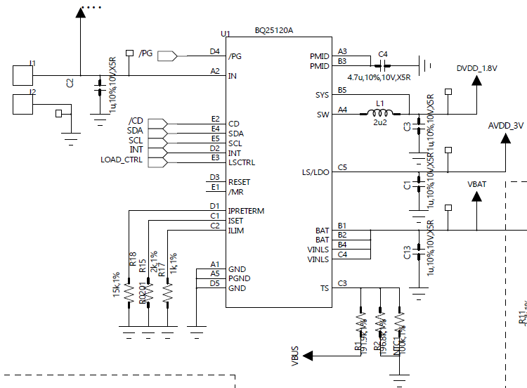

    Now i have another problem about INT pin, the pin can't change state.Because INT pin don't have a pull up resistance, I poll the state of INT pin,it keep same state all the time.
    Here's my schematic of the BQ25120A.
    Also, TS resistoris right?When I enable TS_EN,  a TS_FAULT wii occur( 11 ).
    Is there anything wrong?

    A few comments on your schematic.
    • Is the EN_INT bit enabled?
    • you want to connect VINLS to PMID. Connecting VINLS to battery will prevent proper termination when there is a load on the LDO / Load Switch. Dont forget to include 1uF capacitance
    • I noticed you have /MR floating. Do you intend to use shipmode? If yes, do you plan to exit shipmode only through adapter plugin?

    1.EN_INT has been enbled in TS Control and Faults Masks register.Since the device is so small,it cannot be measured with an oscilloscope.
    Any configuration or other conditions that are not noticed will affect its state? I think the hardware is more likely to have problems.
    2.Very grateful for your reminder.If connect VINLS to PMID,when charging,the voltage is too high for LDO load,it only need 3.3V,any question?
    3.Yes, we will use shipmode and exit shipmode only through adapter plugin.
