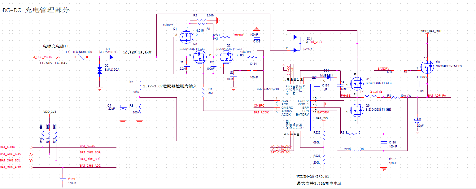

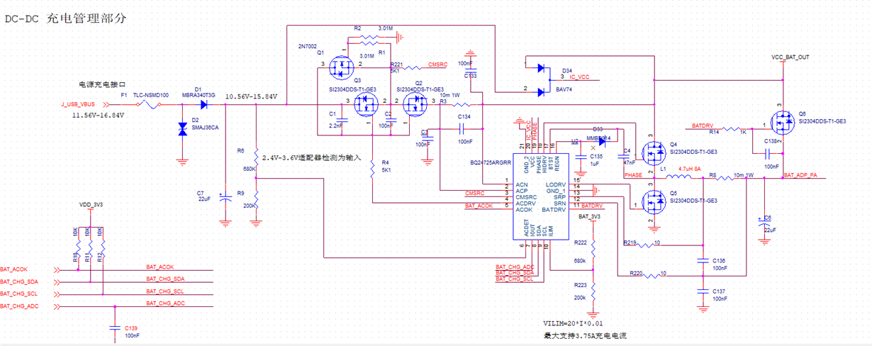

Hi
My customer use BQ24725 can not charge.

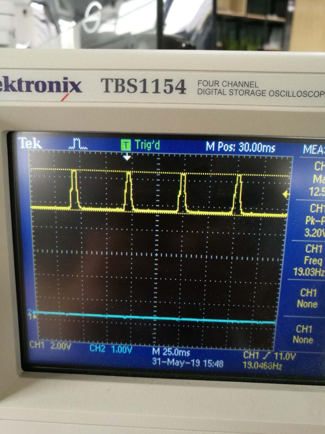

attached schematic and waveform
measure  result as below:
ILIM 3.3V
ACOK 3.3V
D(3pin) of Q4 is 12.5V, ACFET,RBFET is turn on.
input voltage is 16V
Waitting for your reply
Star
  • Hi Star,
    A few comments on your schematic:
    1) Use 1 MΩ instead of 3 MΩ for R2.
    2) Use 100 pF instead of 100 nF for C139.
    3) Add a 10 Ω resistor and a 1 µF capacitor to VCC to form a low-pass filter, as shown in the typical application diagram given in the datasheet.
    4) Is the ILIM pin voltage actually 3.3 V? Based on your resistor divider values, ILIM should be 0.75 V.
    Also, what signal is shown in the waveform?
    Angelo
    This issue has been solved. The reason is that the sample resistor is too big. Thank you for your great support!
