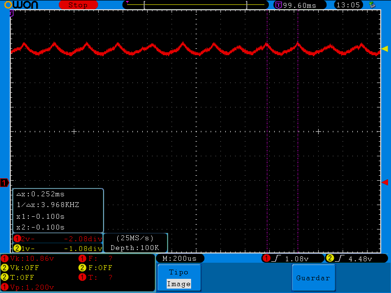

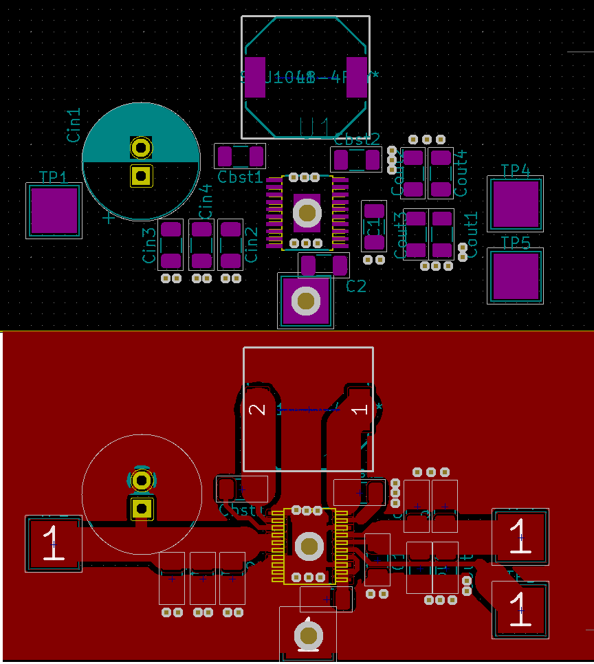

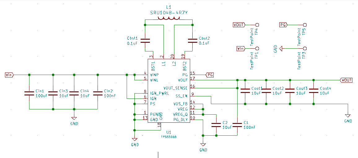

Hi, I'm having troubles using TPS55165 in boost mode, when input voltage is under 15V, the output is aprox. 10.2V, I tried with and without load. it works fine in buck mode.
When i'm in low power mode works in both buck and boost.
10uF Capacitor  https://www.digikey.com/product-detail/en/samsung-electro-mechanics/CL31F106ZOHNNNE/1276-1312-1-ND/3889398
0.1 uF=100nF Capacitor https://ar.mouser.com/ProductDetail/KEMET/C1206C104M5RAC7800?qs=DM5%252B9G31yH3Dk%252BjBZ6yGdA%3D%3D
4.7 uH Inductor https://www.digikey.com/product-detail/en/bourns-inc/SRU1048-4R7Y/SRU1048-4R7YCT-ND/3437981
Output when it doesn't work
