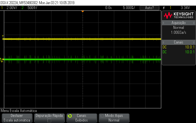

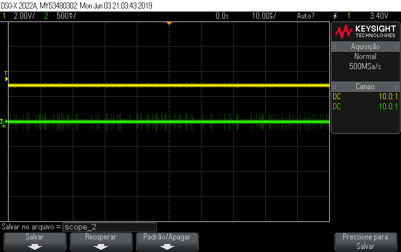

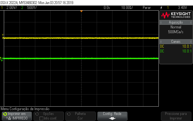

I'm using the TPS61165 to drive six parallel LED, and I would like to be able to control the LED via PWM ( ON, OFF and brightness light). However, the led driver is always on.
Any suggestions appreciated.

I have tested the TPS61165 using the SEPIC topology but does not work with LEDs in parallel. The LEDs keep on with CTRL low.
In my application, I'm using 2 LED Driver with 2 blue LED (LXML-PB01-0030) in parallel per Led Driver and 1 LED Driver with 2 red LED (LXM2-PD01-0050) in parallel for the high intensity of light, and with LEDs connect serially isn't possible to reach the needed high intensity.
