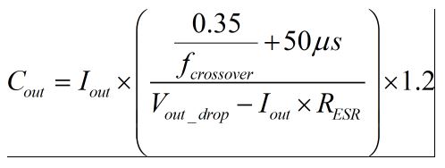

Hello everyone,
could you please Tell me how do you calculate the size of the Output Capacitance (Co2), because my calculations are not matching with the Value that the Excel Sheet (Sluc 664) is recommending me. Could you please tell me the equation that you are using to calculate this. Because there is no usable equation in Datasheet for this.
Thanks in advance!
