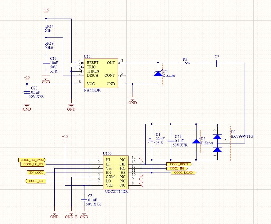

  • Hi Mamadou,
    We would have some difficulties to fit a transformer on the board.
    Would attached circuit work?
     I have some difficulties to predict the behavior of C? due to the filter that we will have between the H-bridge and the load.
    Thank You.
  • Hi Stefan,
    Thanks for following up on this opportunity.
    I have couple of comments:
    -For the bootstrap capacitor, please consider using X7R multilayer ceramic capacitor for their stability over temperature and supply range. We do not recommend using electrolytic capacitors as they have significant capacitance shift over temp and voltage range and reduce their effectiveness in filtering noise.
    Your current bias looks like it is not generating the necessary bias on the HB-HS pin. How did you pick R14, R19 and what is your expected OUT voltage. Have you simulated the circuit?
    As shown below, my simulation shows the OUT pin seems to be stuck on 18mV, I am going to modify it and get back to you as soon as possible.
    Timer.zip
    Thanks.
    -Mamadou
    I have tried to simulate the circuit but I have had issues with the tools so I have not ben successful.
    I have downloaded the TINA tools and that looks nice. I will give it a try and see how it works for me.
    I opened You file and I think that You get 18mV on the output since the "cont" pin is grounded. It should be floating.
    I have only made this charge pump since I don't think that the charging of the bootstrap capacitor will work when we use the LC-filter described earlier in this thread. We use the filter in order to get a smoothed voltage to our load and my concern is that I suspect that the filter must be emptied every time the bootstrap C is charged and then we kind of loose the purpose of the filter. Do You think my suspicion is correct or do You think that the bootstrap circuit will work as intended even with the LC-filter?
    I also noticed that I made a mistake in the 555 connections. The trig and threshold should not be grounded but connected above the capacitor.
    BR
    /Stefan
  • Hi Stefan,
    My apologies for the delay.
    I have updated the file with Cont pin connected to ground through a capacitor since I cannot directly ground it.
    Also as you pointed, updated the Threshold and Trigger pins to be connected to charging capacitor C1. By tweaking R1 and R2, you can get the desired charging and discharging times of the high-side FET using the ton=0.693(R1+R2)*C1 and Toff = 0.693(R2)*C1.
    Then you can run the low-side continuously as you had originally planned. Your provision for clamp diodes are also a good idea against transient surges.
